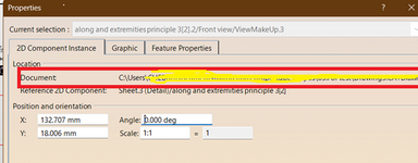

Hello everyone,
I'm trying to retrieve the link (path or reference) of a 2D Component Instance that comes from a 2D catalog in a CATIA Drawing using VBA.
Here's a snippet of my current code:
Sub CATMain()
Dim catia1 As Object
Set catia1 = CATIA.ActiveDocument
Dim myviews As Object
Set myviews = catia1.Sheets.Item(1).views
Dim mycomp As Object
Set mycomp = myviews.Item(3).components
Dim links1 As String
Set links1 = mycomp.Item(1).CompRef.GenerativeBehavior.Document.Reference.FullName
Debug.Print links1
End Sub
However, this line throws an issue because the 2D Component Instance is not linked to a Part or Product, but instead comes directly from a 2D catalog.
Has anyone encountered this situation?
Is there an alternative method to retrieve the source (path or catalog reference) of the 2D Component Instance?
Code:
Dim comp as DrawingComponent
Set comp = CATIA.ActiveDocument Selection.Item(1).Value
Dim refView as DrawingView
Set refView = comp.CompRef
Dim refSheet as DrawingSheet
Set refSheet = refView.Parent.Parent
Dim refDoc as DrawingDocument
Set refDoc = refSheet.Parent.Parent
Debug.Print refDoc.FullName
