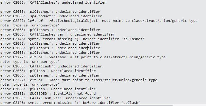

Thank you , PDM is Team Center . When I tried your code, received below errors. What are the headers and interfaces need to be added?
First of all, you missed some of the lines in my code.
Secondly, include files are named the same way as for CAA interfaces: CATIAProduct.h, CATIAClashes.h etc.

Hi I could able to resolve some of the errors. Please see below. Only error is on technological object now.
And I am new to CAA. [sad]. Need your help.
