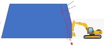

I am interested in learning how to forced a consistent failure in a slope. My company has developed an inexpensive IoT based tilt sensor that is intended to monitor slope failure around critical assets and provide real time data on the angle of inclination. Our problem lies in testing. Based on some reading that I have done, I think that excavating the toe of a hillside would be the most pertinent test and would appropriately simulate the real world application. A crude representation follows. The vertical red lines indicate that this will be an iterative purpose where we will periodically reduce the stability of the slope to accelerate the results of the test.
I was hoping for some direction to a some literature that I could read that may help design a controlled failure for this test. As I am sure that you can tell, my background is not civil related, I am intrigued by the field and would love to learn about the factors that need to be controlled to ensure the test simulates a slope failure in a way that tests the effectiveness of our low cost monitoring strategy. Of course, I will keep everyone posted with the results of the test in case I strike anyone's curiosity.
Thanks for all of your help!

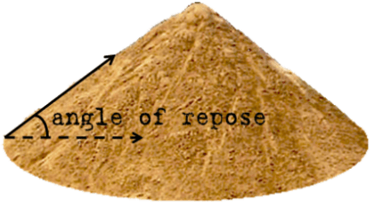

A granular material, like sand, has a relatively well defined "angle or repose":
Create a pile of the granular material with this natural slope, excavate at the bottom as you have proposed, and you will soon get slope failure.
I would not have thought that inclination angle changes appreciably before slope failure. That's why failures occur seemingly overnight. Nobody notices a change in slope inclination until it typically becomes oversaturated with wrainater and fails more or less instantly. Are you saying that there is indeed a slow, measurable change of inclination that can be detected in time to ensure preventive measures can be taken?

However I can't see how the angle of inclination of a slope of cohesive soil can change?
Many other things usually cause slope failure including water content, slip planes, presence of clay or silt layers, changes to superimposed load etc etc. But not angle of the slope which doesn't change.
If you wanted to embed hundreds of strain guages or position of the soil then you might have something which could give you some sort of prior warning but many slope failures are very sudden and result from a rain storm.
