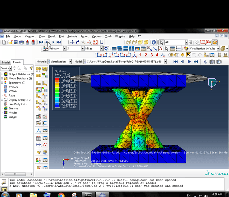

Nov 3, 2020 #1 jzeds Mechanical Joined May 28, 2020 Messages 16 Location IR Hi, I'm running a compression simulation and I need stress-strain curve for the whole model and not on a single element or node. how can I archive this?
Nov 4, 2020 1 #2 FEA way Mechanical Joined Nov 13, 2018 Messages 5,193 Location PL You can use a group of elements and calculate average stress/strain for them. Upvote 0 Downvote
Nov 4, 2020 1 #3 Mustaine3 Mechanical Joined Feb 25, 2015 Messages 1,645 Location FR You can use Report -> Field Output to export results and sum the values. Now it would be easy to calculate an average. But I doubt that it actually makes sense for stresses and strains on a 3D model. Upvote 0 Downvote
Nov 8, 2020 Thread starter #4 jzeds Mechanical Joined May 28, 2020 Messages 16 Location IR should I find the element with the highest stress /strain or average all? doesn't that makes more sense? model: Upvote 0 Downvote
