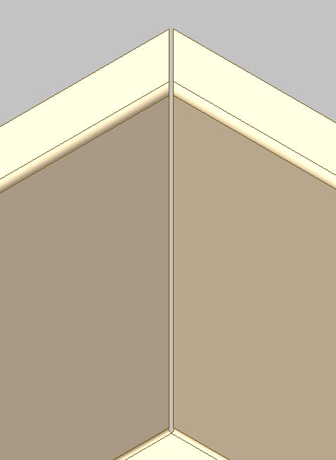

I want to create a gap in miter corner as shown in following image, the miter corner is created with Contour Flange tool. How can I create it?
In NX11, more advanced closed corner functionality has been added to Contour flange.
Select Close Corner and specify the Gap in Corner settings.
For NX10 (and earlier), create the contour flange then create Closed Corner feature for each corner and specify the gap value.
