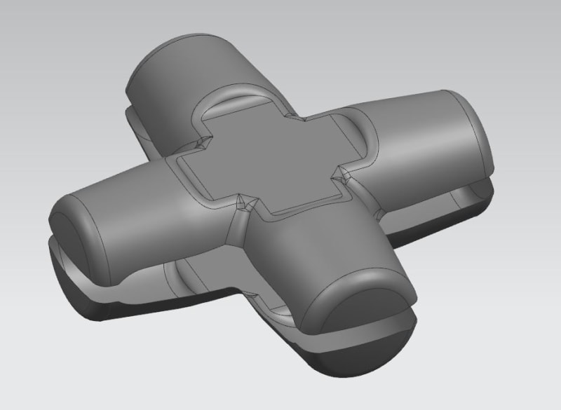

Hello
I have a couple of dies in igs format, they are composed only of surfaces. I want to obtain a solid from each step of forging. I mean, I want to fill voids or empty volume of the surfaces in order to obtain a solid. I just need only one for each step of forging
So could you give any idea
thanks in advance
Do you have only a surface or more than one? In this second case can you perform a SEW of the connected surfaces to obtain only one?
And when you have only a surface, did you try to extrude a rectangle in a solid bigger than your volume (the surface volume must to be totally enclosed in the solid) and trim the new solid with your surface?
I have got this, It´s only the first step
Do you have any idea to convert it into solid?
I have no experience with surfaces.
If your goal is to turn this into a single solid body, you will need to bring the two half's together and then 'Sew' them into a single entity, which if the surfaces form a 'water-tight' object, will result in a Solid body being created. The key is getting that 'water-tight' object, which means that there can't be any 'gaps' or openings. If there are, you'll need to create additional surfaces to eliminate the 'gaps'.

You can also use the external translators (in your Windows start menu for NX) and convert the IGES to a part file.
In the convertion settings you can make a setting which will try to SEW the parts while converting.

What would yo do? either create a new surface between each half part in order to join them or extract the geometry and make it from cero in NX. I tried to dimension it to draw it into NX but I couldn´t get all dimensions. What do you think is the best option?
