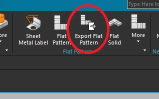

please anyone help me to convert my NX drawing to 1:1 scale in dwg or dxf format(AutoCAD format)..
i have created a sheet metal drawing in flat pattern placing it in A3 sheet at 1:5 scale but when i export it to dwg format, it should show me in 1:1 scale but its still shows 1:5 scale only when i open it in autocad , please tell me what settings i have to follow to accomplish this task in NX..
i have attached a file .prt file, if possible please show it to me how its done..

I think You have two ways to have right drawing in dxf:
1. Use "Export Flat Pattern" in Sheet Metal Module:
2. Change format and scale of Your drawing (to 1:1) and after, export to dxf file.
Best regards
MANok

dear MANox,
its not only problem with sheet metal flat patterns drawings i'm facing , for normal solid model drawings too, im not able to export it to 1:1 scale keeping in any scale into NX drafting file..
kindly tell me in general how to export to 1:1 scale output irrespective to scale in the NX ...
in the meantime i will try your said method to flat patterns , update you back.
thanks,
imtiyaz
In the export options, set the "scaling options" to "base view scale". This will scale up the export by the reciprocal of the base view. Note that this works best when all the views on your drawing are the same scale.
www.nxjournaling.com
Dear cowski,
🤝thank you so much, its worked
