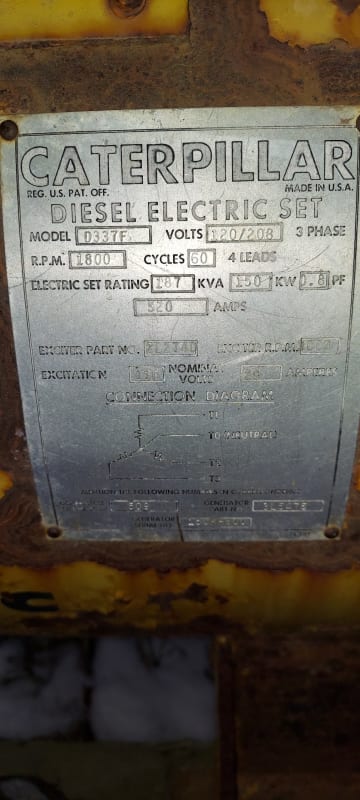

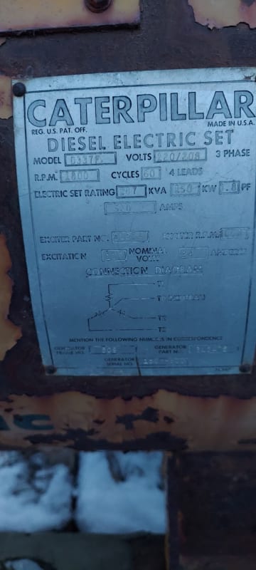

How would I convert a 12 wire generator to single phase to run my home. The generator I'm looking at I attached the tab from. Looking to power a few homes with it.

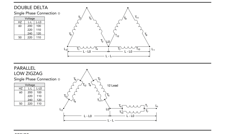

You have a choice of double delta or zig-zag.
Thank you is one better than the other?
That's what he said then, I found a video of one online and it is not. I think the guy bought it think it was and is just saying it is to unload it. I saw on the Tag it says 4 lead, I'm going to keep looking for a different generator that either is single phase or a 12 wire to convert. My home has electric heat so need at minimum 30kw but want bigger to power all buildings.

A single voltage generator is a rare bird. The nameplate doesn't ways tell the whole story. A picture inside the enclosure could give better information. If it has 9 leads or more the transformer option above is viable. If it has 12 leads you can wire directly for single phase.

If it's a 12 lead generator you can wire the stator coils in double delta or zig zag to get the lower output voltage.
Voltage regulators often sense L-0 for high voltage and L-L for low voltage so making a voltage change on the generator may not require changing the regulator.

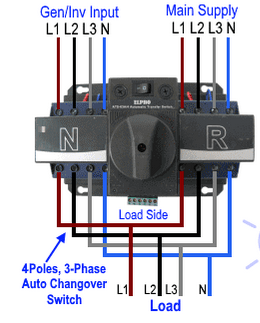

After distributing your loads in 3 phases, use an automatic/manual 4 pole load transfer switch as below.
For utility supply on the top right (marked as mains supply), short L1,L2,L3 on the mains input side and connect your single phase utility input to (L1+L2+L3) and N. This way you can use your 3 phase genny supply and the single phase utility supply separately.
You need a good certified electrician to do the 3 phase load distribution and the load transfer switch installation.

Thats a 4 lead generator according to the plate.
You positive its 12 lead? Have you looked at the connections?
