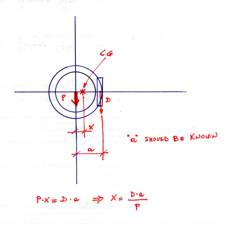

Hi guys,
I have a steel pipe with the dimensions shown below:
Length of the pipe = 6.4 metres.
External diameter = 2.48 metres.
Internal diameter = 2.46 metres.
Self-weight of the steel pipe = 6766.85 kg (uniform steel pipe).
A steel door of 120 kg is bolted to the right side of the steel pipe, in the middle. Can you please help me with calculating the centre of gravity?
 https://files.engineering.com/getfile.aspx?folder=757a36ca-090e-4b96-9925-9dcc71e0bda5&file=Pipe.png
This is the same as finding the area centroid of any shape, and shouldn't be too difficult to calculate. Just replace area (A) with the weights, and define the corresponding distance from an origin you select, in the following equations (Although you only need to calculate one of them, since the center of gravity is going to be at the center of the pipe in two directions).

Thanks for the reply. If it was a 2D beam, I can do it. But here, we have a 3D steel pipe with a door weight of 120 kg to the side in the middle and it confuses me. Shall I treat it like a 2D and solve it with reference A the start point of the pipe?

1 - since the structure is symmetrical all along the length of the pipe, the CG is on the middle of said length
2 - in the other direction you can make a section as below
"P" is the total weight ... pipe and door.
"P" : weight of pipe only (without the void of the door; and, of course, it is not exactely on centerline)
