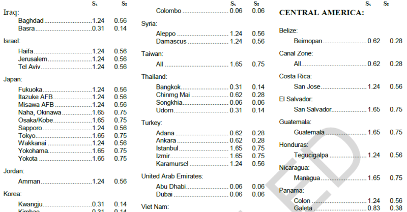

I have gone through the Table 3-3 of UFC 3-310-03A, 1st March 2005 (Unified facilities criteria) for S1 and Ss value.
But am not sure whether to go with is or not.

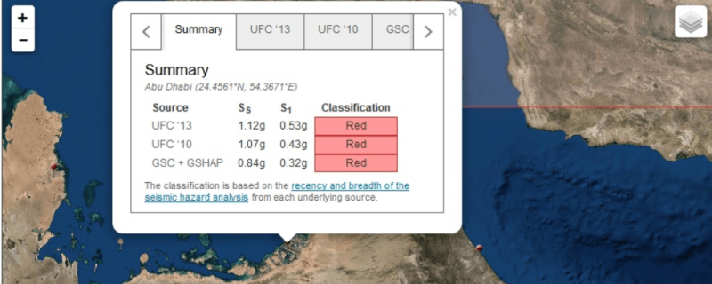

If you are struggle with local seismic coefficients, this tool provide by USGS may help. It refers UFC13 table F-3 for values. Link

I got it from the link (Seismic tool design world wide) above posted by retired13. It worked fine earlier, now I could not get in to that website again. I really do not know why.
You can use the value that are shown in snapshot that i posted. Hope it helps.

It does not work it seems. It shows "undefined" when i tried to get data for Dubai.

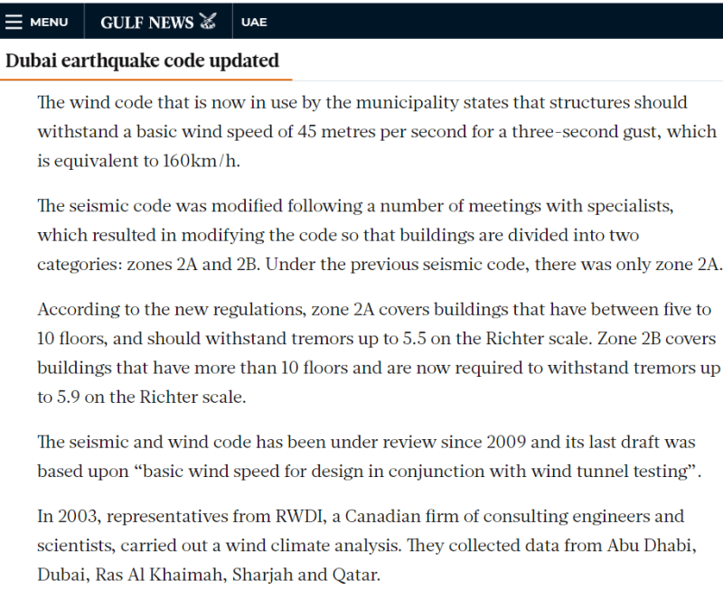

This article addresses recent changes of wind and seismic design code in Dubai. Link
