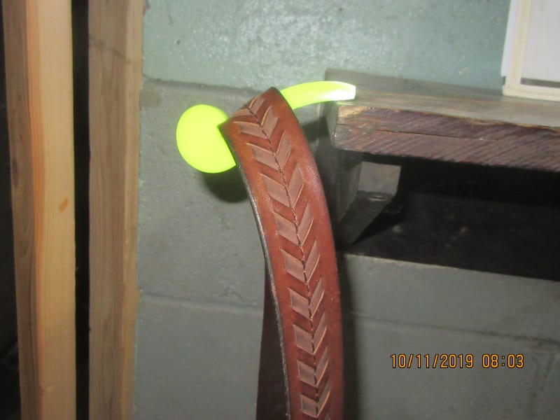

Just curious if anyone has ever analyzed a Devil's Hook to show mathematically how it works. I had one of these in the 60s but lost it. Never knew what it was called. Recently found out it was called a Devil's Hook and found them for sale in Magic Shops and some other novelty internet sites. Attached are some photos and a sketch of the dimensions. I know it is all or partly related to loading through the shear center. These cost about $2 and both kids and adults are amazed by them.

I was curious if someone had done the mathematics on it also. The belt almost always hangs with a slight curve to it due to how it is set in the notch. I was not sure if it was the shear center or the center of mass that has to align with the contact point on the shelf. It would be easier to review if the belt was not an old used belt but a fairly straight new one without a buckle.

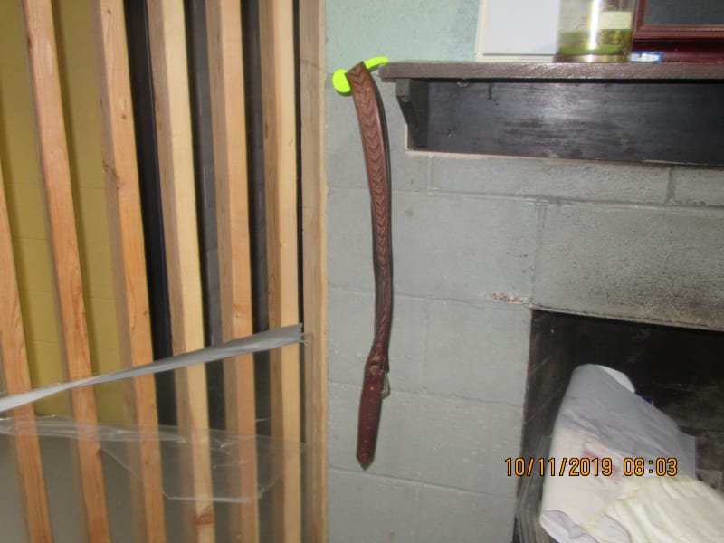

The picture below is looking straight at it with a plumb bob. The string running over the top of the shelf makes it look like I am on an angle, but I am not. In looking at the specifics:
Where is the center of mass in the picture?
Where is the shear center for the combined hook and belt?
The hook touches the shelf in one place right at the edge but it is a line, not a point.

I never said it was a mystery to me. I wondered if anyone ever did the math. There are several things that must happen for the hook to work. I do not think it works if the hanging object does not curve. It will not work if the hanging object hangs straight down and is not forced to curve. It does not work if the item inside the slot can rotate inside the slot rather than curve the object.
Of the locations you could call the CoM, none of them appear to align with the edge of shelf.
CoM of belt is center of the belt at the slot? Won't work.
CoM is halfway down the hanging ends of the belt. To me, that location does not appear to be aligned with the edge of shelf in the picture.
Just looking at the picture, it looks more like moment of mass to left of string must equal moment of mass to right of string.

Fun. I think that the "trick" to it is in recognizing that there's a uni-directional moment connection between the hook and the belt that turns the the thing into a moment frame the shape of a 7. After that, it's just statics on a rigid frame as others have alluded.
Agreed, the main trick is in the belt to hook connection. The hard part for me is what is it that has to align with the support in order for the thing to become "magic". And where would you call Center of Mass? Am I incorrect that there is some relationship to the shear center included in the puzzle or is it just that the hanging chad has to have some curvature to it.

That would be the same as saying the center of mass aligns with the center of string, but actually, the center of mass aligns with the edge of shelf (right edge of string).

I think the CoM of the belt is to the right of the plumb line, as the plumb line is the edge of the shelf, and the hook contacts to the right of the edge.
I wonder how the fit of the belt in the notch affects things ?

If the item was a folded rigid strap it would have no surprise. It needs moment continuity, as supplied by the slot.
Nothing to do with shear center and everything to do with the centroid of the combined 7-shape thing. A vertical line run through the tail of the hook "comma" should pass through the centroid of the combined shape.
I think it is as Kootk described. There is a couple created by one face of the notch and the opposite side of the belt on the other surface. The notch is 1/8" but I think you could use a thinner material as long as it is stiff enough to allow a couple rather than to bow-up. I found an belt that has never been used but it has a heavy buckle. It works terrible as compared to one with a light buckle.

The belt is rigid enough that it cannot rotate in the slot. Therefore, there is a rigid moment connection between the belt and the hook. The hook would not work to hang a loaded string instead of the belt.
Elaborating on Kootk et. al., I think the "shear center" concept is clouding the issue. I agree a C section beam spanning between two supports can support an offset load located over its shear center without rotation, but this is easier figgered as a rigid frame.
The centre of the gravity force of the hanger thingee and the belt must align horizontally with the pin support. Equilibrium tends to do that. All of you saying the centre of mass and hence centre or line of vertical force is to the right or left of the support need to go back to statics 101.
