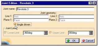

You could use the Kinematics workbench to animate the blade motion. This will allow you to specifiy the lower and upper limits of the blade rotation.

I did that for the actual animation and it works in kinematics workbench, but when I go back to the assembly it still turns 360 degrees. Any way to costraint it in assembly design?
You could add a pin to the blade and have it move within a circular slot in the handle (180°). Add a coincidence constraint between the center point of the pin and the centerline (half circle) of the slot. This will limit the rotation with the Manipulation tool if you choose the option With Respect To Constraints.

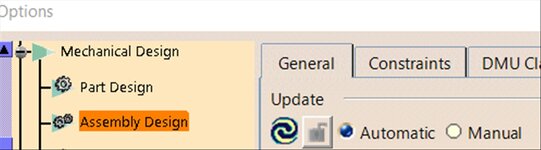

I would set up assembly constraints. When you modify the angle constraint you can set limits.
If you set your automatic update in the assembly design options, the component will rotate as you change the constraint.
Constraint Limits and step amounts can be set with RMB on the value input box.
