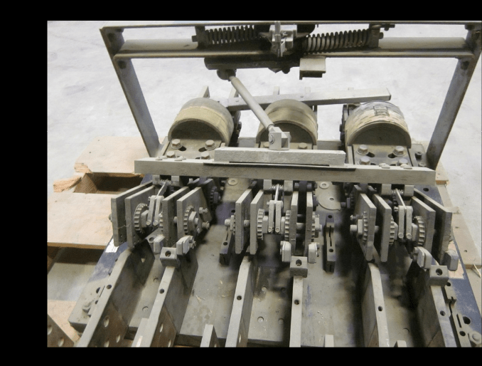

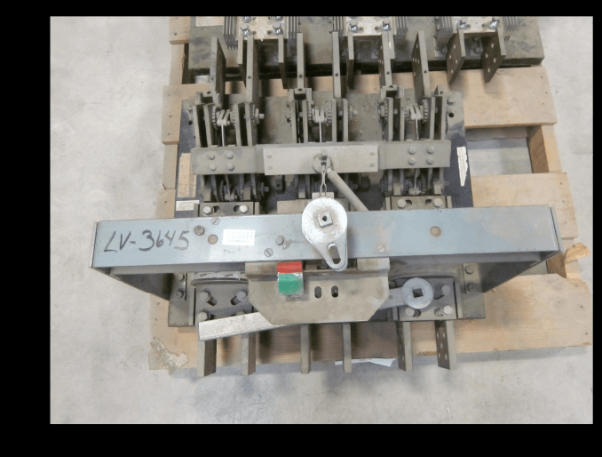

Attached is a section of the Buff book on how to protect a small motor should it ground fault. It refers to a "bolted pressure contact switch". (I'm assuming this is a motor contactor?) It goes says the switch should be equipped with an anti-single phasing option and a shunt trip. That sounds reasonable but I'm not sure I've seen that done very often.
What really goes on during a ground fault that's protected by fuses ? Is it always going to single phase and you just have to happen on a strangely functioning motor/other load, and manually turn it off ? Or do they just all escalate into 3-phase faults and that's what trips the entire circuit ?

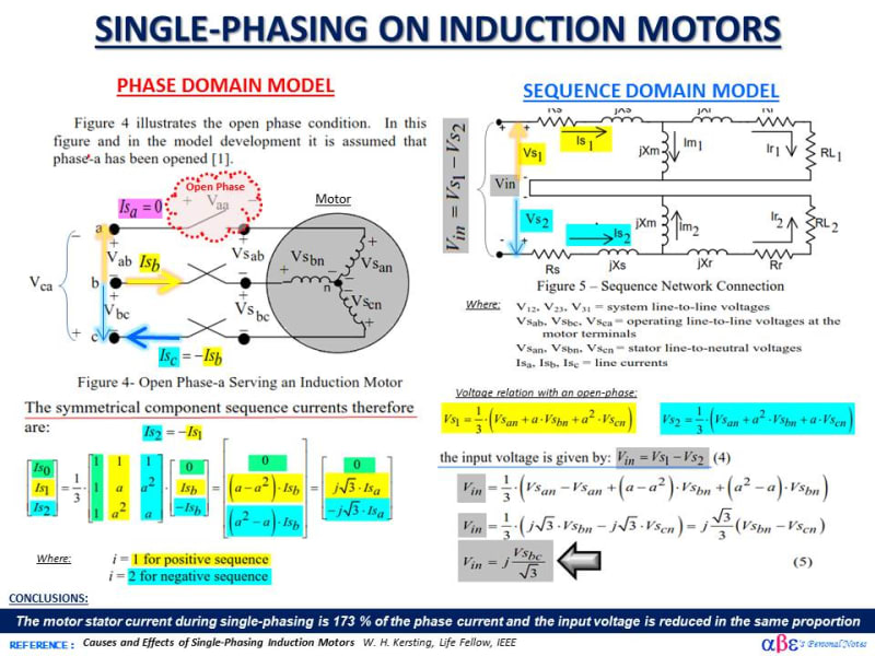

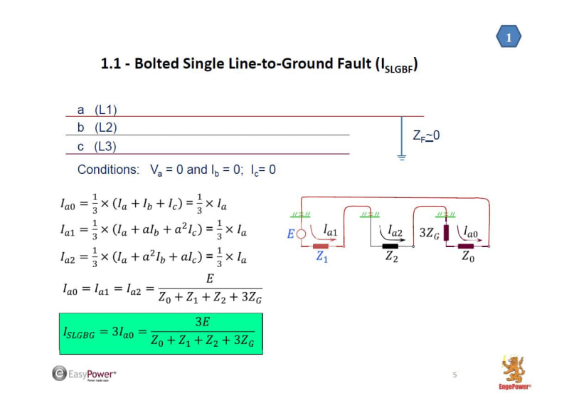

I'm still confused about that too. But look at this symmetrical components calculation for the Single Line to Ground Bolted Fault. The conditions are: Va = 0, Ib = 0 and Ic = 0. Which implies ALL the current is in Ia. How can that be? Maybe they are saying the magnitudes are so much greater in Ia, that Ib and Ic are insignificant. Even the Buff Book article I reference in the original post it makes this statement...
"In addition when a single fuse isolates a ground fault, the fault can still be fed from the other phases through the motor windings, even though the current magnitude has been greatly reduced."
I have greatly appreciated the discussion on single phasing motors, but as has been pointed out - that's not the same thing as a single line to ground fault at the terminals of motor causing one fuse to open and the others not opening.
A single line to ground fault on a wye system is the same as a line to neutral load. Think of it as an overload. It doesn't matter if the cause was an overload or a fault, once the fuse blows.
A point of clarification. When we consider the effects of single phasing of a motor it is with the understanding that any fault that caused the loss of a phase no longer exists.
A flashover caused by a rodent, a bird or a dirty insulator will often blow a fuse but clear itself and leave the line unfaulted but with one phase open.

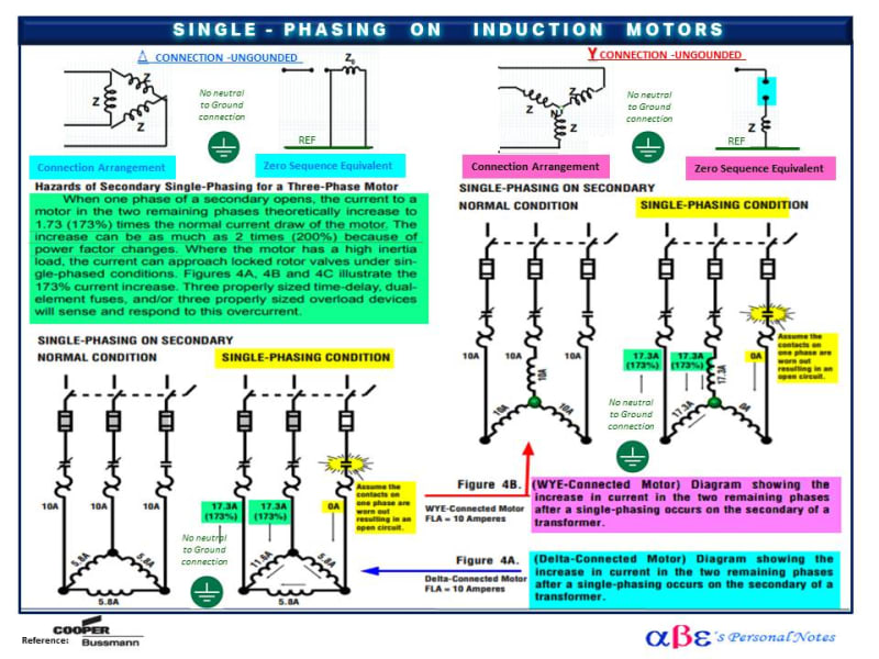

Single phasing:
You need three conductors to get two phases. Loads that incorporate a neutral connection will see two phases. With A phase lost neutral connected loads will still see B phase to neutral and C phase to neutral.
A motor has no neutral connection. With A phase lost it will see only single phase power supplied by B and C phases, line to line.
It is common to designate loads connected line to line with no neutral connection as single phase loads.

I attended an impressive demonstration some time ago. A running motor was single phased briefly by pulling a primary fuse. The motor got very loud and sounded nasty. The same motor was reconnected to a three phase VFD. When the fuse was pulled again, the motor continued to purr without a hickup. Prevention rather than protection.

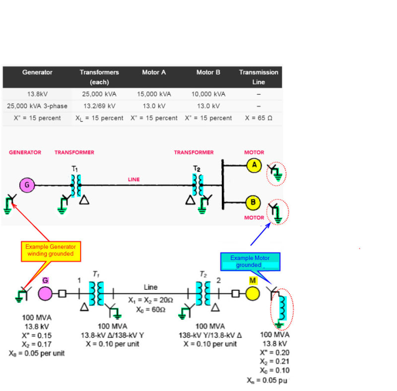

Below are a couple of examples of one-line diagrams with large motor grounded.
It is that correct? The previous statement indicates that motor stator winding is not grounded.
Seems like your talking about two things
1 Loss of single phase from power supplied
2 Loss of single phase on a individual motor.
If you have loss of single phase from power supplied would not you just have the relay pull emergency stop on loss of phase.
If you have loss of single phase on a motor that is thru your overload device.
