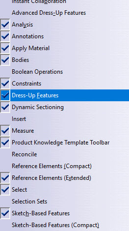

How can you create assembly constraints in a Single catpart with solid bodies.? See attachment 1
cemunal2000
Jan 5, 2016
13
DE
I have a single catpart which contains assembly constraints(Coincidence,Surface-Surface Contact,etc.)in it.
I have never seen such a single catpart like that before.
Do you know how to make it?
Please see the attachement.
Thank you
 https://files.engineering.com/getfile.aspx?folder=4b17e833-a421-4672-99ae-35fab13153b0&file=How_can_you_create_constaraints_in_a_single_catpart_with_solid_bodies..JPG
It is not a common practice... usually one does it in assembly.
But if you have dead bodies, you could pretend you are in Assembly on part level... there is a tool-box called Constraints in PartDesign... and you could repositiond those using the constraints.
