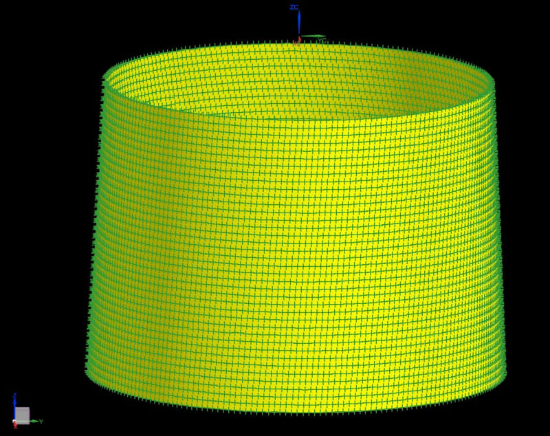

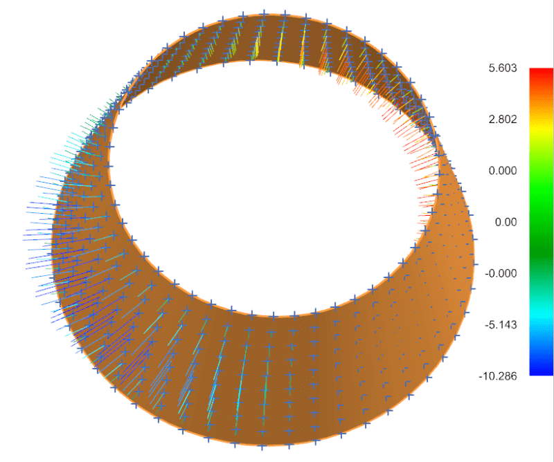

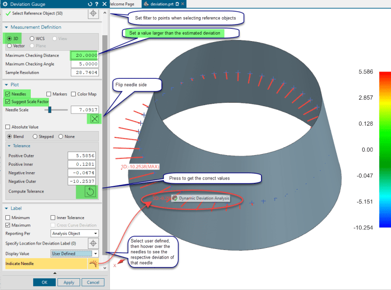

The Deviation Gauge is not that simple to explain with few words...
here's an image which hopefully gives some lead.
I have a set of points which deviate from the surface , I reduced the number of points to these 50 for clarity of the illustration. The second image is 500 points and shows both the color scale and the colored needles.
When selecting the reference objects , use a selection filter else you will also be comparing the distance to the local edges etc.
And , you MUST set the "maximum checking distance" to a value larger than you max deviation, else those "worst cases" will be ignored.
When you have selected the objects, tick the "compute tolerance" to receive the correct values.
Hope this clarifies the function somewhat.
