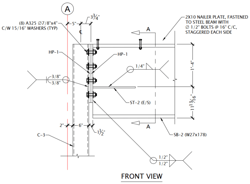

Interesting, any idea what the horizontal stiffener here is doing then? It's a main floor beam, not loaded axially.
From what I'm reading, horizontal stiffeners are used to strengthen against web buckling due to bending compression, but being at the end of the member the bending should be nearing zero at a pinned support.
Perhaps the designer has anticipated moment transfer at that joint, either intentional or inadvertent?

Not indicated on the drawings and no design loads were given, nor was instruction on what to design the connections for. RFI's it is.
Then my vote is that the stiffeners were detailed to deal with inadvertent flexural compression in the bottom of the connection. I've never done that but I certainly see the logic in it. I would expect the web of the beam to be in flexural compression near where that stiffener is located.

That horizontal stiffener is very likely there because the welded end plate does not extend down to the lower flange. And downward bending is going to put a compression stress concentration on the web, and the horizontal stiffener is needed to prevent local buckling of the web. IMO it is a very bad design; the welded plate should extend down to and be welded to the lower flange of the W27.
Those type of stiffeners are usually put in to stiffen the web to increase the bearing capacity of the beam web in compression or to stiffen the end plate to increase the tie capacity of the lower bolts but the column doesn't look like it wants to take much moment

When I look at the detailing, it suggests a steel, gravity only frame within a surrounding wood structure. My responses are geared toward that assumption. If this is meant to be a portal frame or something, that changes things.
Looking at the beam size (W27x178) and all those 7/8" bolts, it seems like someone is hoping that stiffener somehow helps in shear. The column can't carry much moment, inadvertent or not.
This dovetails with our previous discussions about whether or not the column need be designed for the load eccentricity. I'm sure the 100+ kip reaction would wreck that little HSS6x6 column if the load is applied eccentrically.

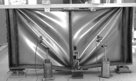

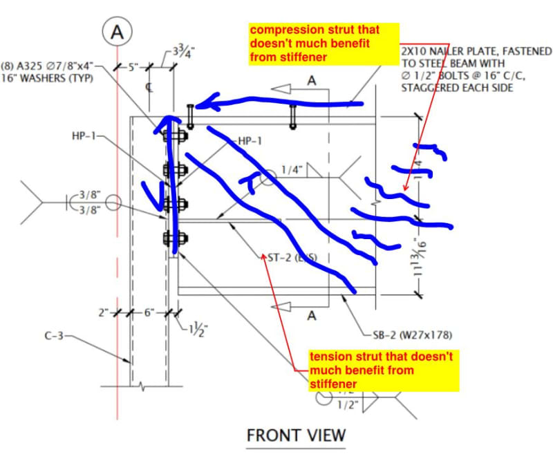

For sport, let's imagine that we knew that the designer's intent was to increase shear capacity. Do we feel that the stiffener would be effective? I see things like I've shown them below.
Do we actually know how long the stiffener is?
Man, 27" beam with like a 13+" width on a 6" column.
Reasons I can think of:
-Just not liking the stiffness variation between top and bottom and eyeballing in a load path they like better
-Wanting to laterally restrain the bottom of the beam more rigidly, maybe being really explicit on detailing to ensure that the beam is laterally and torsionally restrained at the support
-Using the connection to transfer diaphragm forces somehow (no idea to where) so wanting some into the page lateral and torsional stiffness
-Using the connection to stabilize the column off of the diaphragm, so wanting that same lateral or torsional strength
-Restraining a tear-out mechanism of some sort (really don't see it)
-They have a typical detail and they're expecting to cope the beam bottom on some of them
-They have a typical detail and some of them require moment capacity or one of the restraints above
-Detailer grabbing a connection they've used before
Are you sure this thing isn't a diaphragm collector or something?
With just this, my best guess is restraining the column
I imagine it adds to shear capacity in the same way that any flange does
Why yes, I do in fact have no idea what I'm talking about
I think it should be a little longer to be effective. The increase in shear strength is based on the 'buckling' of the web. Having different 'heights' for the web member forces it into a different buckling mode.
You'll have to hold my hand a bit here. How does "any flange" improve shear capacity?
