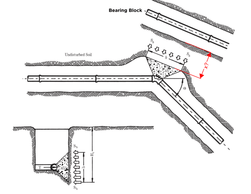

I have a reaction block on a waterline horizontal bend. How do I calculate how far back from that block before I can start another trench?

I'm not very good with posting pictures, but here goes:
The block isn't vertical 45deg out from the bend. The height of the block goes from the top of the bend to the bottom of the trench 6" below the pipe.
How do i calculate x such that the reaction block isn't compromised?
Assume thrust force = 10k, soil bearing pressure is 2ksf, soil density is 100 pcf, soil friction coefficient is 0.4. burial depth is 3 to top of block.
area of block in contact with soil meas 1.25'x4'
In this case , the new trench depth is an important factor.
Assuming the new pipe trench depth Ht ,
The resistance will be based on base and side friction of the soil block.
The size of the soil block resisting with sliding,
V= 4.25*4* X = 17*X
Weight of the block W=100 *17*X =1700X lbs.
Base friction resistance = 1700X*0.4= 680X lb
Side friction resistance assuming at rest pressure cof.. 0.5
Side friction resistance = 4.25*100*0.5*0.5*4.25*X*2=903 X lb 903X+680X=10000lb ⇒ X=6.3 ft apply a F.S . for temporary case , say X=8 ft.
Another solution, you may provide trench shoring at new trench to get smaller X value.

We don't know how big your pipe is but if your reaction force is 5 tons, that some size pipe.
From the outside of the block I wouldn't go much closer than 4 to 5 feet. Get too close and once the ground starts moving it's too late....
So find out how far the block goes back from the pipe and measure from there.
Or if you need to get closer hammer in some sheet piles about 10 ft long to contain the movement before digging the next trench. Then after you Bury and compact the soil around the new pipe closer then you can pull the sheet piles back out.
Design a mass and friction block. I wouldn't count on support from the soil wall above h/2.
Good stuff.
Sorry, 1 more question. Is the friction force from the weight of the block negligible?
Apparently the existing thrust block designed for passive thrust . However , you can add weight for the base friction . I think would be negligible.
Your soil bearing pressure 2ksf is overestimated. Assume friction angle 30 degr. Kp =1.5/0.5=3.0
Lateral soil bearing pressure would be the passive thrust at average depth =3.0*5*100=1500 psf apply a FS 2.0 gives 750 psf.

Sorry, I’m a little thrown off with the side friction. Is that the same as skin friction?
The terms look like (soil depth)^2 * (coef)^2 * (soil density) * 2 * X.
Did I get that right?
