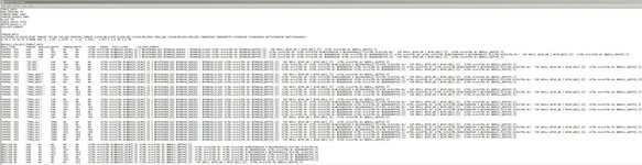

I've been working on creating a .hol file for our standard format in my free time and came up with the attached file. It'd be a good start point for anybody.
2010-12-13_091849_UNC-N.zip
That would be the correct answer for the question at hand. Adding DEFAULT_CALLOUT_FORMAT_DATA to the .HOL file will allow the user to set specific callouts for different hole situations.
I had some issues copying the text, but I this file has DEFAULT_CALLOUT_FORMAT_DATA options that work, so I finally got the formatting right.
