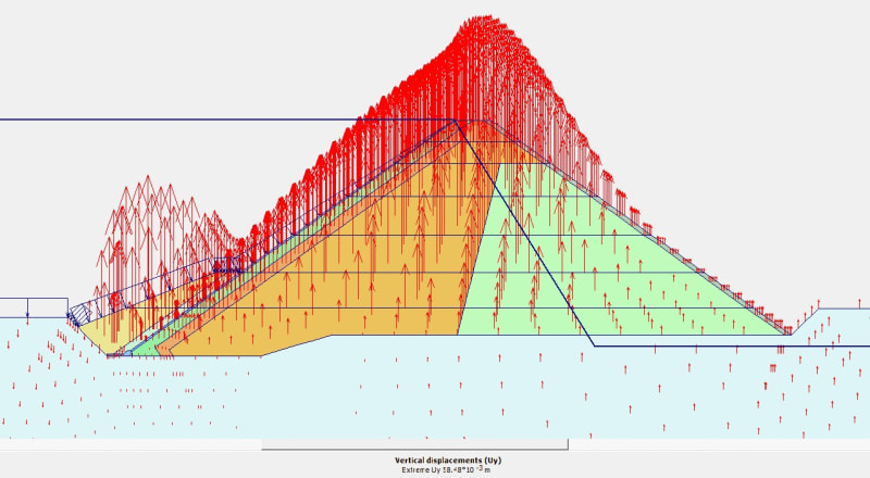

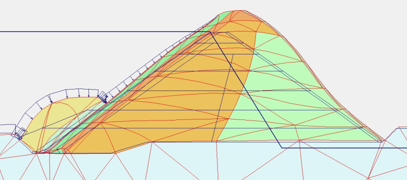

I am learning Plaxis with an older version.
Why does Plaxis lift the model when the reservoir is full?

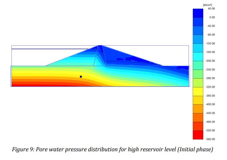

Run a seepage analysis first to stabilise your pore pressure
I didn't understand what you mean cvg ?

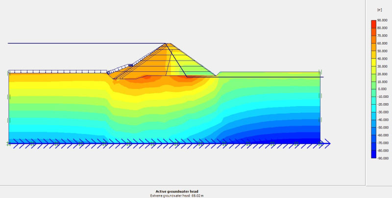

show a plot of your pore pressures just before failure
Your pore pressure distribution should look something like the below. Make sure you set your pore pressure calculation type to steady state groundwater flow. This is all discussed in Plaxis tutorial 7
I solved the problem thank you EireChch
