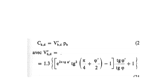

And also in the attached graph, according to De Beer, the equation is used on the condition that : when Ø´ is greater than Ø(provided). Inorder to find out this Ø´ i have use the below equation.
And for calculating the effective friction angle, i need to convert the above formula into Ø´= ....
Where the values of Ø , Ckd(=qc) and σv0 will be provided.

Regarding your quote: Vb" = Ckd /Pb where Pb = y'z (overburden pressure) and Ckd (cone resistance) are both "effective" stresses ..
