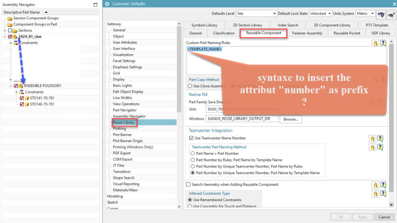

Hi, I have a reusable component 1

I have a reusable component with KRX file and I would like to rename it with a prefix equal to a specific attribut
Thanks in advance

If I'm correct you need to place question-marks in front of <TEMPLATE_NAME>. The number of Question-marks indicates how many characters and they are incremental.
Not sure if this will end up in numbers or letters....this you have to try

Just use any attribute like <ATTRIBUTE_NAME>_<TEMPLATE_NAME>
They will use the attribute from the parent.
