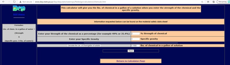

Hi All,
I am adding a KMnO4 chemical feed to my filtration compact package unit for the iron and manganese removal. I have a 50 gallon mixing day-tank and will be using powder KMnO4 for the solute to get 2% strength solution. The CAIROX potassium permanganate powder is 97% guaranteed with 2.703 g/cm^3 specific gravity. I've used the PADEP chemical calculator and got 0.451 lb/gallon solution as the result. So I would use 0.451 lb/gallon X 50 gallon = 22.55lb for 1 batch of my solution. Is this correct? Is there a formula to calculate the amount of KMnO4 that I need to be using? Thank you for your input.
thread164-432736
Water weighs 8.34 lbs per gallon, for 50 gallons that would be 417 lbs. If you want a 2% solution, 2% of 417 lbs is 8.34 lbs. If the KMnO4 is 97%, divide the 8.34 by .97 to get 8.6 lbs for the 50 gallons.
Since you are already familiar with the PADEP, use the calculator on their page:
