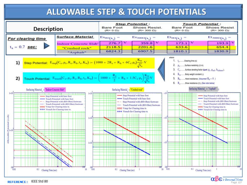

Not sure if we can help without known the system parameter and if any grounding calc or test been performed. Main parameters such as design LGF current, grounding/earthing topology, soil resistivity, protective device clearing time, etc are required to be known.
In Liu of calculation, a grounding/earthing test by trained and qualified personnel may be acceptable.
In the absence of any field data, the following generic suggestions are offered:
1) In the grassy area, a perimeter conductor 3 ft (1m) inside and beyond the fence is often used in HV facilities to mitigate any hazard step and touch potential.
2) Analyze if a crushed rock surface (4" to 6" thick)is necessary for the grassy area to increase the allowable potentials.
4) All the metallic parts above grade such as card reader, speed sign, security building, fence, and the gate should be grounded and connected to the main grid.
5) Use a flex conductor for the sliding gate. (Some design spec. approved coiled traveling grounding conductor).
6)In the concrete slab (<100 Ω.m), check if there is rebar that can be grounded and use as an equipotential surface (similar to an Ufer ground). In the asphalt area (10,000 Ω.m wet) the allowable step and touch potential are fairly high compared with the native soil. Depending upon the system grounding parameters and calc, there is a possibility that the area is safe without doing major digging & cuts in the area.
7) Calculations model and/or actual grounding tests are highly recommended.
If the step and touch potential are met in the native soil, there is no much concern with the asphalt area and even the concrete slab. Double-check if the concrete has rebar. Both surfaces can be modeled and can confirm if there is an issue particularly with the touch potential.

The grounding calc compares the actual voltage rise during a fault with the allowable step and touch potential which is dependent mainly on the surfacing material and the clearing time as indicated in the example shown in the figure below.
1) Asphalt (10kΩ.m) provides the highest allowable voltage in the fenced area.
2) Concrete is very tricky since varies significantly with moisture. However, its hygroscopic characteristics particularly for outdoor slabs, keep moisture from the soil helping to minimize the variability in resistivity . Most likely this site (TBD) was build with rebar. if this is confirmed, the slab can behave as an equipotential surface and minimize or eliminate the need for additional grounding loop.
SUGGESTION: Ask the engineer to run two cases:
1) CASE 1: Asphalt 10 (kΩ.m) and thickness as installed (4" ?) (Expected to work without install buried conductor)
2) CASE 2: Concrete 300 Ω.m.and consider modeling with footwear instead bare foot.
2.1 Without Rebar (most likely require grounding loop)
2.2 With Rebar (most likely not require grounding loop since behave as equipotential surface.)
