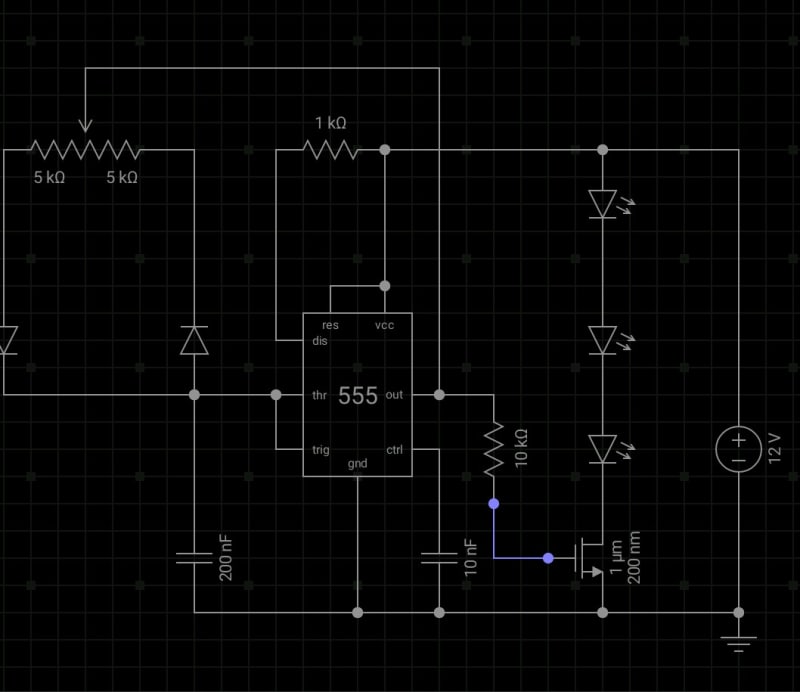

I gave up and migrated to PWM
It works good. Only two FETs totaled on the process (that's a win [dazed])
But as predicted, there is no such a thing as 0% duty cycle, so the light never goes off
There's 1% or something close, but no zero
Kudos to whoever solves this. No idea came out of me.
I have this:
Pot: 1k
Diodes: 1N4007
FET: Si2302DS
Resulting frequency is something between 500Hz and 1kHz. Well defined square wave.
But that can be reduced to fit the solution, although it will cost me a fatter capacitor or a larger pot. Both undesired
Instead of a 555, try an SG3524 or SG3525 if they're still available. 0% - 100% duty cycle modulation.
You bet me to it, Scotty.
But there is another way out. It will only cost you a small capacitor and it will help reducing EMI down to levels that may help you getting the product (if it is going to be one) okayed by EMC test houses.
The PWM has, as you observed, Clean and Sharp edges. That means that the current into the LED strip contains lots of HF harmonics. The original astable flip-flop, which was used Before the 555 and its cousins were available, was also named "Multivibrator" because its output was so rich in harmonics. And the 555 is richer, still, because of the optimized design.
To get rid of those harmonics, you can add a capacitor between Gate and GND. That will ramp up the gate voltage so that it never reaches turn on threshold at low duty cycles like 1% and that keeps the LED:s dark while allowing Close to full output at 99%. You will need a C that produces 1 - 10 us and that means a C like 1 nF or thereabout.
How would that help fighting EMI? Simply by reducing the di/dt in the LED chain and, since upper HF limit is proportional to di/dt, you can control the HF emission with the same capacitor.
There may be one problem; the FET will not switch as fast as before and that means some extra thermal load (stays in linear region somewhat longer). I wouldn't bother too much about that. Just try out a suitable capacitor that turns the LED:s dark at lowest D.C. and keep a finger on the FET to feel if it gets hot. And remember - hot means a lot more than 50 C, where your finger thinks it is hot.

Awesome, man
Worked perfectly. 3nF did the trick. No heating at all.
Good to know about this harmonics handling method (we all know how to get rid of noises, but some of us need a reminder sometimes)
Good to know about this SG3524 too. Although this capacitor trick is an elegant and cheap solution
Two stones with a single bird
