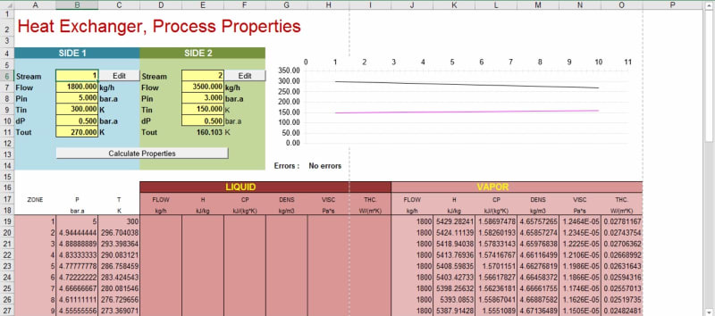

rense, Free PRODE version may not be able to do so but I will really appreciate if you can upload some screenshots regarding your procedure (which appeals to me greatly)
With Prode Properties I am able to calculate all these values (compositions and transport properties in each zone) as a table in Excel for further processing, you may ask your client to do the same...
Iomcube,
Not sure if that is what you are looking for but there is a simple Excel page which calculates the properties in different zones (see image)
it works with all versions of Prode Properties, including free version
