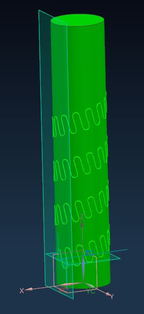

Hey all,
I'm trying to draw this helical zigzag wire that appears in the picture, but I can't figure out the best way to go about it.
I've planned to make it a sweep, so I projected the flat pattern in a cylindrical face and the used the helix pattern, but it came out weird because I had to eyeball the helix variables and ended up creating bridge curves to connect the instances:
How would you do it ?
I would do it something like this:
Draw/wrap one instance, insert planes to measure for values for helix pattern geometry. NX11 file attached.
That's just perfect, thank you !
