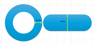

Hello, everyone.
I will be performing stress relief heat treatment on 4140 steel specifically for a part as shown in the image with these measurements.
My question is, what thickness is appropriate for heating, since the standard tells me that it should be at least 1 hour per inch?
And generally, what heating ramp do you use?
Thank you for your support.
Follow the procedure of AMS2759/11
Unless other wise specified
Generally the stress relieve temperature is -50 degrees F below the tempering temperature.
Again follow the spec
Agree with mfgenggear.
By the way - that is a very poor representation of how the part is designed/actually looks.
The right-hand oval should be oriented vertically, not horizontally - or placed above/below the left-hand image if the orientation is not changed.
Take a look at "third angle projection".

To my understanding, start up the oven with thermal probes, or thermocouples until the the correct temperature is reached. Then the time one hour per inch is used.
The "ramp" is to allow for the rate of temperature rise via thermal conduction through the part, as in, don't expect the transformation to happen any quicker.
What matters is not exceeding the required temperature and that the entire bulk of the material reaches the required temperature and for long enough for the crystal structure to achieve equilibrium.
The measurement is for any point inside the material to the nearest exterior surface.
