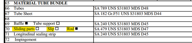

I'm involved in a project where I'm supposed to understand all terms in the RDS-019 datasheet from NORSOK, that is for Shell & Tube Heat Exchangers. Can't complain so far, with the help of the internet and some discussions with CGPT, I managed so far, even with no experience to mention. Now I'm stuck with some attributes that I couldn't find anything helpful about.
These that are in line 70. Are all of these components related to sliding the bundle in the shell? Is it how it looks in this example, that you can only have one of them (they don't work together for a single purpose)? Simply, what are these? and how do they relate to each other? is "Sliding parts" an inclusive term for the other two?
I will highly appreciate any pictures that can help me understand what those are.

Sorry that I forgot to mention that the tie rods are covered somewhere else in the datasheet, so I think the rods here are something different. That's actually a big part of the confusion.
I've seen a lot of pictures, but couldn't recognize what the parts in question are.

Rod or bar type baffles are used to eliminate dead or stagnant flow zones on shellside - there is a description of these on page 11-42 in Perry Chem Engg Handbook 7th edn. Must confess I dont know how these look or work though.
I've never seen those terms before but my guess is that "Slip" might refer to skid bars which are typically made from flat bar and are welded to the baffles/tubesheet and "Rod" might refer to bundle slide rails which made from round bars and are welded to the bottom of the shell (only applies to TEMA "K" shells). Just a guess though.

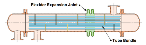

Hello Khaled,
The most probable difference between sliding and rod type is that sliding will have parts that have flexibility to move. For example adding an expansion joint on the shell side. The expansion joint will allow the shell to expand and contract during high temperature application. See picture below:
Online source: https://www.thermalproducts.com/PDF/FlexiderUSA/Flexider_Heat-Exchangers_FL.pdf

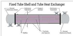

The "rod" style means that the shell and heads are fixed using rods. Below is an example. Notice that the rods and tubes are fixed on ends making the expansion and contraction of internal components limited.
Online Source: https://www.iqsdirectory.com/articles/heat-exchanger/shell-and-tube-heat-exchangers.html
Let me know if this helps and makes the concept clear.
