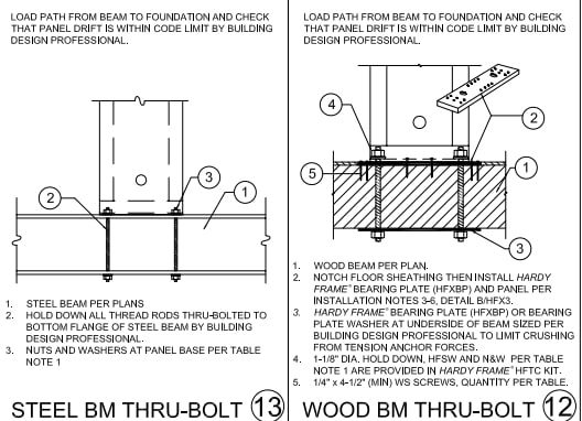

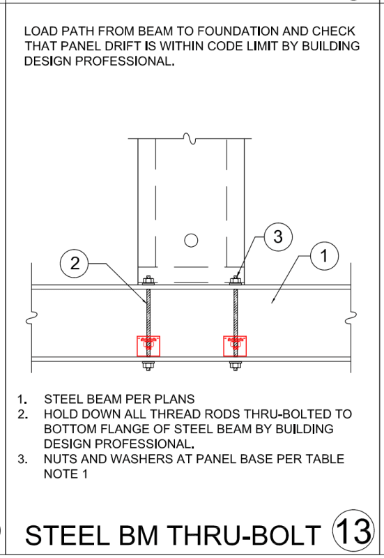

I have two Hardy Frame Panels to be installed on a steel beam in the upper floor of a 2-story residence. My question is regarding the attachment of the Hardy anchors to the steel beam. Mitek wants you to drill thru both the top and bottom flange. They specify the nut and washer above the top flange, and require the design professional to specify the nut & washer below the bottom flange. My problem is the bottom nut & washer would protrude below the bottom of floor framing and may be difficult to conceal within the 5/8" drywall.
Has anyone ever welded to the top face of the bottom flange? And perhaps add a secondary nut & plate washer on the bottom face of the top flange? Any other ideas welcome! I am happy to share loads, sizes, detail, etc as needed.

Never used Hardy Frames either, but I looked at the details from here:
Perhaps you could weld some angles above the top flange to raise the attachment point as desired:
Looks like a detail conceived by a draftsman. (not yours, Bones)
I don't get why they run it all the way to the bottom flange.
My guess is they want to engage the entire beam cross section, but they leave it up to the EOR to design for the local limit states.

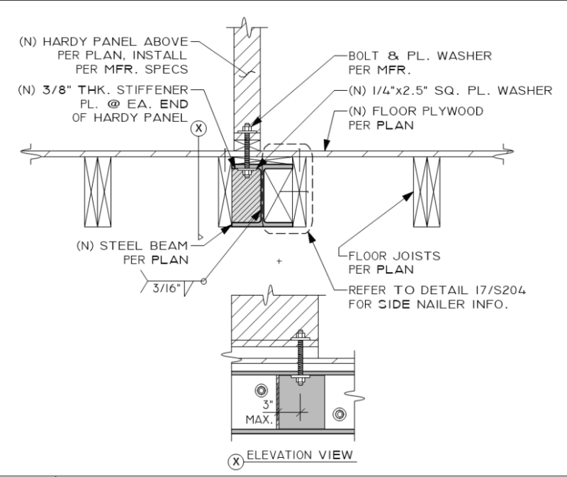

Thank you both for the responses. I failed to mention I had the stiffener plate detailed as well and the Hardy detail makes no reference of one. This should do the trick? I like the angle idea as well but may be not be needed due to the stiffener plate.

Now that I see your detail, I might change my response and suggest an alternative solution with the beam centered below. I don’t like the eccentricity here, although perhaps it can be justified.
Are you suggesting two stiffener plates be added on the near side, where the anchor occurs? Or one on the far side of the web behind the anchor location? I am going to detail the latter as that stiffener can be directly aligned with the anchor itself. I am reducing the eccentricity on the near side from 3 to 2". This was for workability purposes.
Originally, I was thinking two stiffeners on the near side and two on the far side (on other side of web). But that was assuming the beam was centered and also assuming 4 bolts (not 2). With it being eccentric, I would have the two stiffeners on the near side where the bolts are and maybe on the other side as well, although I’m not entirely sure. The far side stiffeners would be beneficial for resisting torsion acting on the beam at that location.
With any eccentricity I might also add solid blocking between the beam and at least the nearest joists to either side. That will help restrain the beam from twisting.

The first note is about the detail the shared. Per Mitek installation details it appears they want the panel flush with the top of the beam. It appears by your detail, there will be a bottom plate, subfloor and nailer that will all be in compression when shear is applied to the top of the panel. Not sure if this is an issue but Mitek's installation details indicates it should be avoided.
The second note is about how the installation detail appears to show the system working. When shear is applied to the panel, Miket's installation details indicates the top flange will be resisting compression and the bottom flange will be resisting tension. This allows the moment to be decoupled between the top and bottom flanges.
If the top flange is thick enough to resist the couplet, then only the top flange would need to be engaged. Your approach of
combined with the stiffeners, I think would provide a conservative solution but by doing so each flange would be seeing part of the couplet and I would think that this needs to be checked.
