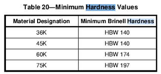

Dear all,
Good afternoon,
The API 6A standard specifies the minimum hardness values for carbon steels with a yield strength of 36K to 75K.
I have a hardness standard from a client that informs the minimum value for steels with a yield strength above the API.
Hardness standard text:
The minimum Brinell hardness values from ISO 10423 or API 6A [1], ISO 13628-4 [3] and API 17D [4] are given in Table 2.
Could you, if possible, inform me from which literature my client obtained these minimum hardness values for steels with a yield strength of 80ksi to 120ksi?
Att,
Wendel Trento
ASTM A370 only reports equivalent tensile strength for steel hardness, not yield strength. There may well be some proprietary equivalency but I do not think it is reported in any standards. This is the standard of your customer so you have to make sure you meet it.
The API 6A material designations are based on the yield strengths but there is also a tensile strength requirement for each material designation. The hardness requirements are based on the ASTM A370 hardness equivalent for the tensile strength requirement for each material class.
