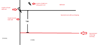

Basically, I hung a heavybag from a ceiling joist for about a year in my basement. It always shook up the kitchen that's directly above it when I used the bag, but other than that it worked fine. Recently however, I noticed a couple of things that concerned me so I took it down; first the adjoining bathroom had a long crack in the paint on the ceiling. I did renovate the bathroom a couple years ago, so maybe one of the drywall segments wasn't secured properly and it just sagged on its own. I just added a couple more screws, patched it up and repainted it and it's been fine since. But the other thing is a bit more worrying, there's a crack in the outside wall of the room with the heavybag. The joists in the basement run perpendicular to the wall in the picture, and they sit at about where the bricks begin in the picture. The thing is, the joist I hung it on is about 5 feet to the right of where the crack is. Is it possible that the vibration from the bag could have caused a crack that far away? There's nothing on the part of the outside wall that would be where the joist with the heavy bag was hung.
The second part of my question, how much impact would putting a 2x6 perpendicular to 2 of the joists and hanging it from that would make to the structural integrity? Any suggestions on how to take away stress from the joists when hanging it?

Oh okay. The rest of the wall looks pretty normal, no cracks or anything so that's why I included a close up shot. I'll snap a couple pictures tomorrow but in the mean time, here's a little diagram I made of the situation that might help

More likely that what ever you did with that bathroom joist has pushed just a little bit on the outer wall. That "crack" is tiny and not in any way structural.
Having said all that, any repeated forces can do strange things and it would be much better to create or buy a freely supported frame.
