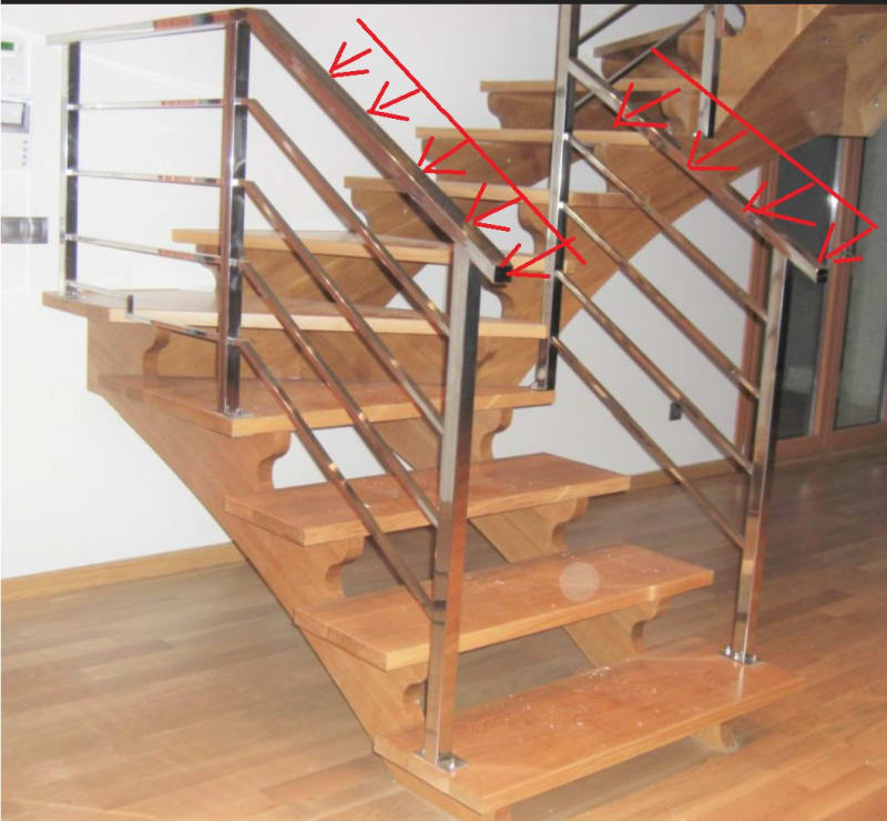

Hi engineers,
the required load for handrail abour forum is 50 lb/ft or a 200 lb concentrated load, in what bibliograhy I can found information?, is life or dead load?

On the stairs there are two handrails on both sides, it is enough to load on one of them horizontally, or is it necessary to load both handrails?
i'd go with both, but you might be able to say that by inspection the LH one is more critical.
What is the maximum deformation in the handrail, L/?
All the handrails have to meet the requirements. Loading one side vs the other side is really irrelevant to the handrails and its connections. If there is some loading you are concerned about the in the elements supporting the handrails you might want to consider the loading on each of them simultaneously or perhaps just one side. Which ever causes the worst effect.

The loads are live loads and are applied in any direction, therefore it's not just horizontal, you need to also check as if it's a vertical load. Typically you check for the worst case of 50 plf and 200 lbs, this is why manytimes vertical supports are spaced at 4'-0" o.c. such that 50 plf loading is equivalent to the 200 lb point load. Deflection is a tough one for these, I'm not aware of anything other than the normal deflections for say a wall. There may be some OSHA requirements that it rebound to its original installed position. Make sure to review the codes as the loading is applied at a certain height. Many times I find that the controlling elements are the vertical supports and the connections.
Ok, thanks. I am reviewing the load considerations because on sap2000 model, when to load the handrail with a horizontal load of 50plf the beam that supports the steps increases stress and deformation, and when to load both handrail this increases more.

I would say by inspection that the fastening to the treads is critical.
As Aesur says, the load can be in any direction. It looks like inward toward the stair centerline will be the worst case for the fasteners in your photo.

I would be worried about that center post connection to the pointy end of the tread.
And would be worried about the left side straight railing that doesn’t seem to have a connection to the wall, and with the column base bolts not alined with the sideways moment.

JLNJ is correct... I'm pretty sure those fasteners to the wood don't work.
That stair, the guardrail, and the OP all look like a middle school shop project. Start over and try again.
