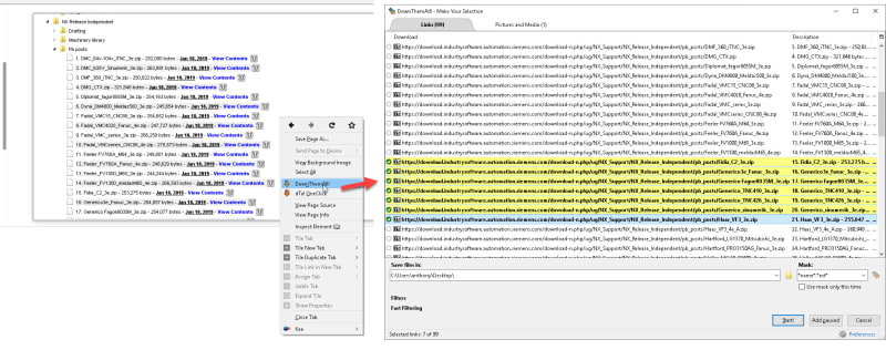

Hello,
Is there a way to download post processors from GTAC as a single download? I use to do it before Siemens cut off access to their ftp server.
I have many posts that I want to download but I see no way to do it other than downloading files individually and I'm not thrilled about downloading 100+ files one at a time and keeping them organized.
NX 12.0.2
EVP's
You could try what I do & use Waterfox with DownThemAll.
I've always preferred Firefox as my default browser and used the plugin DownThemAll to download any large files.
Since the change in Firefox a while back that has changed the way plugins work, DownThemAll is not supported in newer releases of Firefox.
Waterfox is built on Firefox but allows the old plugins like DTA to run: Image below shows how it would work
I noticed today that there is now a version of DTA for Firefox, I haven't tested as yet, but that would probably work.
