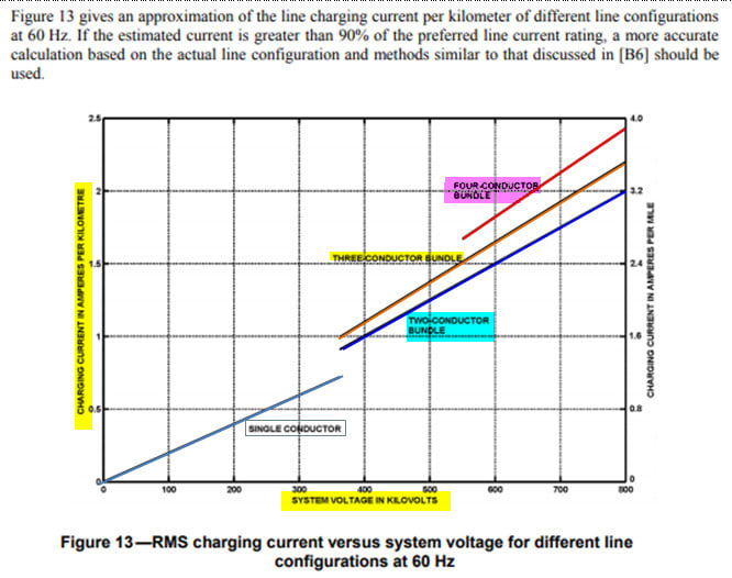

I hope all of you are doing good. I have a question about grounding switches. We have a 230kV switching station with (1) 230kV double circuit double bundle line coming in. It is about 16 miles long. I am trying to figure out whether the disconnect switch intercepting this line will need a grounding switch to discharge any charging current or not? Any help on how to determine that will be highly appreciated.

A good substation design practice at this voltage will provide a grounding switch no because of the charging current but to provide grounding for inspection and facilitate safely maintenance, repair, or replacement of other substation equipment.
The estimated charging current produced by the line described is around 16 amps (Considering ~1A/mi per the enclosed graph).
Most of the line capacitive current will be discharged as an arching during the breaker and main switch disconnection process. The grounding switch will operate later usually interlocked to avoid misoperation.
Grounding Switch Rating: It should be noted that the traditional momentary (asymmetrical) current rating is now covered in the standard by the peak current rating. To obtain the 3-sec ratings, divide the momentary current rating by 1.6. The ratio of the peak withstand current to short-time (symmetrical) withstand current is 2.6. Rated duration of the short-time (symmetrical) withstand current is three (3) seconds with allowable I2 t variations given in IEEE C37.34. Rated duration of the peak withstand current test is 167 msec (10 Cycles).
