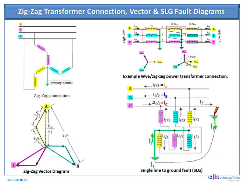

At difference than the delta source, a zig-zag power transformer will provide significant fault current to trip the protective device in the event of SLG fault.
As an example predicating a SLG fault in ΦC, the SC currents are as follows: IA=IB=If/3 and IC=2/3*If.
For an illustration of zig-zag connection, vector diagram, and representation of SLG fault see the figures below.
For an existing or new "ungrounded" delta system, there are options to derive a neutral with a grounding transformer to create a high resistance system. The appropriate selection should be based on economics or other site specifics such as space, weight, size.
The sketch below shows a couple of examples to illustrate the concept to derive a neutral point through grounding transformers.

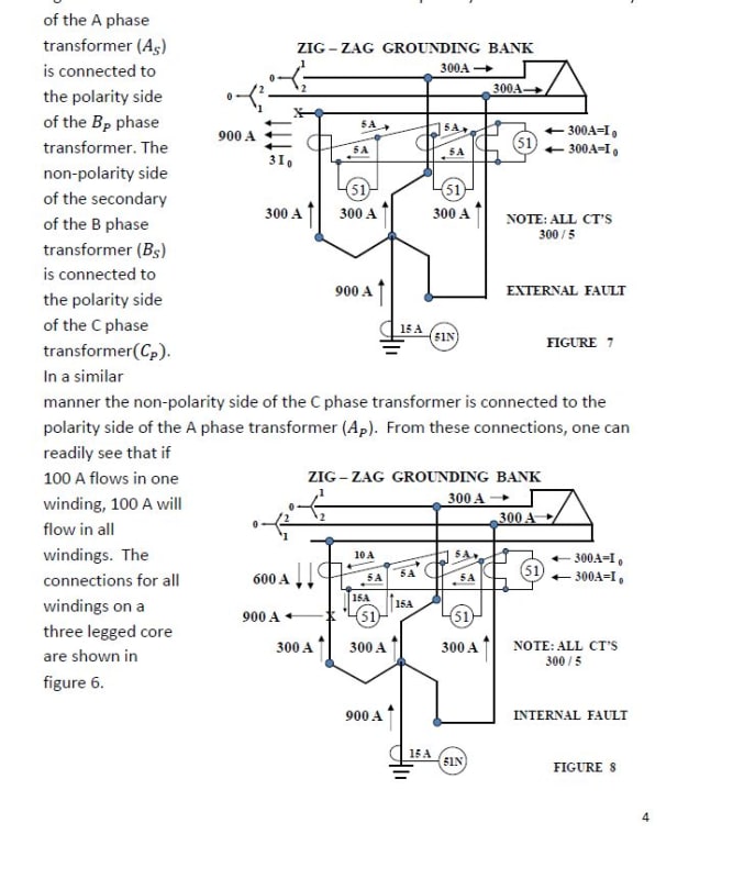

Can the zero-sequence CT be installed on the neutral point of the zig-zag?
Thanks,
EE
You betcha Curious;
The zero-sequence CT is always installed on the 'neutral point' of the zig-zag transformer. (ie in series with the ground resistor).
GG
"I have not failed. I've just found 10,000 ways that won't work." Thomas Alva Edison (1847-1931)
7qnother4,
May I ask what the reference is for the excerpted diagram?
