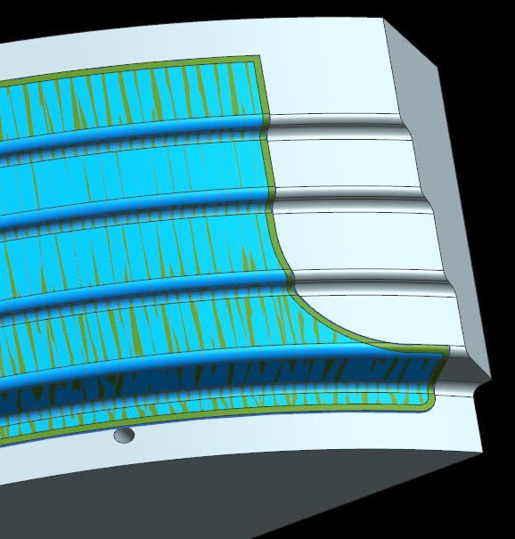

Greetings:
Attached is a model of what we call a buck that our part sets. The projected lines is the part perimeter. I am attempting to put a .100 wide x .100 deep groove around this perimeter and trying to make it such that the .100 stays normal to surface all the way around. Is this possible?
Thanks in advance for any help.
Brent

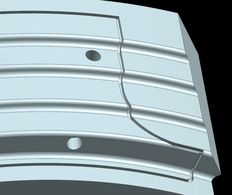

A sweep to face normals seems like the obvious choice but I was unsuccessful. I tried using thicken surface shown below but don't think this is exactly what your looking for.
Barnon,
Acually, the thicken surface looks to be exactly what I'm attempting to do. Did you just thicken surface the side of the part?
Thanks,
Brent
I made duplicate instance of a solid you already had in the file, offset one side and then subtracted it. I tried to apply an offset to the inner face but was unsuccessful. I then extracted the inner face, thicken and subtract.

I see now what you are doing. The problem is, I need that groove on the outside side of the part perimeter. I do notice when we offset inward (-.10), the offset occurs successfully. When I try to offset outward (+.10) it will not do it. This is why I'm having a problem with this one. Anyway, thought I would share, and thanks again for your time.
Brent
Yep... I noticed that as well. You'll notice the red dots on the problem areas when offsetting. Usually when a surface disappears and it doesn't know how to handle it.

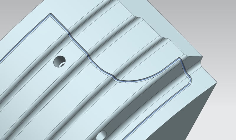

Probably of no use but the pic below is several tubes driven by your perimeter line and then subtracted. I could see machining this with a ball end mill.
