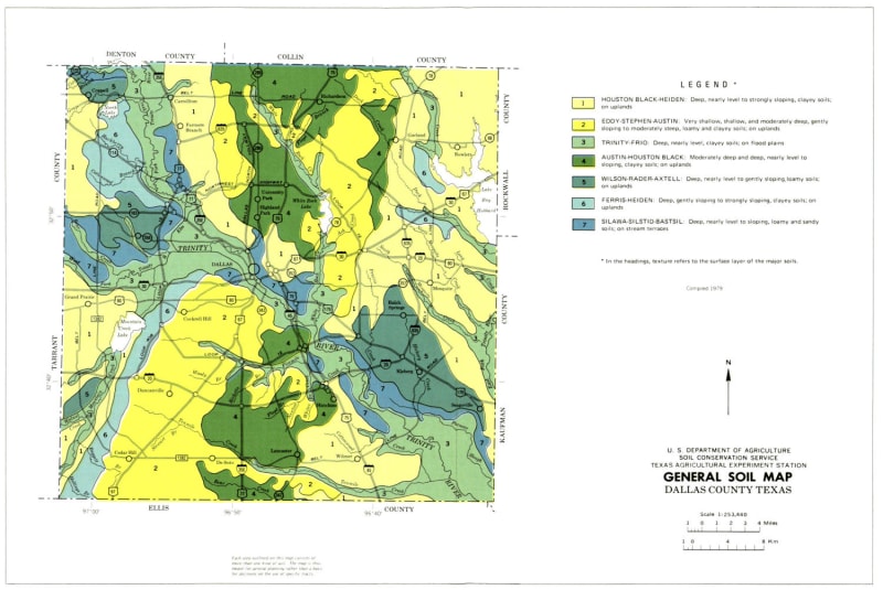

We took you too literally. You didn't mention that it should only include things you already have experience with. But frankly, basically underground gravity drainage on large flat sites always makes a need for deep excavations somewhere, or worse, lift stations. Personally I'd blade and grade to drain and be done with it. In Dallas, maybe the sun will come out and evaporate half of it before it reaches the corner. Underground, no chance. I lived in Arlington and there are (were that was 50yrs ago) a few small gravel deposits north of there in the Trinity, but really there isn't much gravel in Dallas, or all of Tx really. Almost every soil class leads to a high % of clay.
