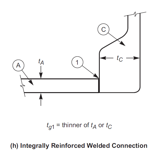

hi all,
i am reviewing a calculation of the MDMT of the forged neck.
it's about how to determine the governing thickness.
it's a forged nozzle constructed of SA-105 produced to fine grain practice and normalized heat treatment.
it's butt welded to the shell constructed of SA-516 70N, which is illustred as following sketch:
i have some question as follows:
1. notes of figure UCS-66 indicates Curve B applies to "A/SA-105 forged flanges produced to fine grain practice and normalized, normalized and tempered, or quenched and tempered after".
it's specific to forged flange, what if it's a forged neck? not curve B?
2. what is the governing thickness of the forged neck in determining its MDMT? 18mm(thickness of neck-to-shell weld)? or 73.5mm(thickest portion of the neck), or 20mm(thickness of neck-to-flange weld)?
BTW, the interior thickness of 6.5mm is stainless steel cladding.
any comments appreciated.
@SJones
i indeed read lots of threads of UCS-66, but i find no post explicitly dedicated to my inquiries.
especially regarding the governing thickness, i looked through Figure UCS-66.3, i still can't get the philosophy of the CODE.
for example, is the tg1 in sketch(h) is just the governing thickness of the corner weld or governing thickness of the entire forged neck?
it's puzzling.

@SJones, you're correct, it's a vessel built to ASME VIII-1, i'am trying to evaluate if forged neck shall be impacted.
in the meantime, i am trying to thoroughly figure out how the code is performed in calculating the permissible MDMT of a part without impact testing.
i read through UCS-66, and i understand it as follows, please correct me if any error. thanks in advance.
in the case of the forged neck, i shall use 3 governing thickness (that of two welds, and thickest portion of neck ) respectively, specifically it's 18 mm.20mm,73.5mm, and look up the curve B (SA-105, FG+N) for the MDMT in figure UCS-66.
the warmest MDMT governs, is it correct?
3" is not the governing thickness. See UCS-66(a)(1)(-4) again.
@david, do you mean i needn't consider the thickest nominal thickness of the forged neck in determining governing thickness?
Assuming your flange is Curve B (SA-105), yes. Your 18mm weld is Curve D to Curve B, while the 20mm weld is Curve B to Curve B (assuming SA-105 flange).
So the 20mm curve B would be the worst case scenario.
thanks david.
why does ASME code ignore the nominal thickness of the neck, which is much thicker than the welds in my case?
heavier thickness, worse toughness, isn't that true? it's confusing.
anyone shed some light on the topic? sorry for so many inquiries.
