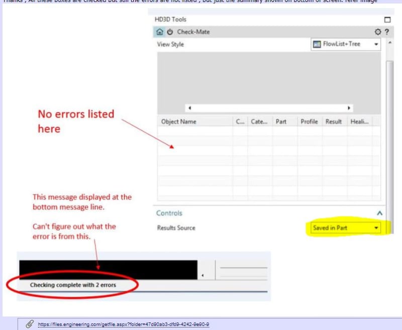

Usually when we run the GM NX checkmate, the check mate results are listed describing the errors ( eg. part/entity on wrong layer). On one of our computers , when we run the checkmate, it does not list any errors, but just a message is displayed at the bottom of the NX window saying 'checking complete with XX errors', this is not helpful to the user as he cant figure out what the exact issue is. But when we check the same file on a different computer , results are listed put just as normal. I would like to know if there is a setting somewhere which needs to be set to get the results listed. If any one has come across this issue / knows a fix kindly share the relevant info. Thanks in advance.

Thanks , All these boxes are checked but still the errors are not listed , but just the summary shown on bottom of screen. refer image
Hi
I'm almost sure you will succeed,if you change your results from: Saved in Part to: Recently Run
If not the results was saved into the part, during chek-mate execution,you cant see any in the HD3D browser...
