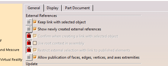

Publishing global params like that?
well, yes. but check your CATIA options first, tools-options-Infrastructure-partInfrastructure-general-"restrict external selection with link to published elements"
regards,
LWolf
Yes, so it is "locked", I assume it is locked by my CATIA system "administrator" and I would need to ask support to release it. Many thanks!
