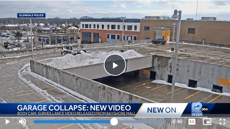

There has been some recent discussion for snow load increases in the upcoming codes, here is another recent failure that may have been related to snow loading.
Video
Article
More information
Our last snow fall here was actually about 2" of slush and ice.
A stack of that would weigh a bit more than just snow.
"WISN 12 News also obtained surveillance video from before the collapse. It shows plow crews on the top floor of the garage pushing snow to the area that would later collapse."- from the third link above.
Proudly designed with very tight margins right up to the limits of the code, I'm sure.
Surveillance video before the collapse. Bobcat was piling snow into one spot.
And from the looks of it, right over the longest unsupported span in the building.

Yeah, but I bet they went and jumped on it and said "yep! strong enough!". Everyone knows jumping on something or pushing on it with your hand is a sure sign of a structure's ability to withstand the most severe forces that can be thrown at it.
I was listening to a radio talk show a few weeks ago and the hosts were disturbed by intermittent episodes of the building shaking and swaying. They thought it was an earthquake. Turns out it was a snow plow clearing the parking garage on the lower levels. They speculated whether the building was designed for that kind of impact loading. I was thinking to myself, nope most definitely was not!
Precast Double Tee panels. It looks like two panels secumed to the snow load. We still have work to do to ensure safe work protocols on elevated structures. It's not like this hasn't happened before.

Cars don't weigh as much as you think. A pile of snow can easily exceed the design loads for a parking garage. Parking garage loads are skinny!
JLNJ editorial comment: I think this is a weak point in the code.
The parking garage architect bears reponsibility here ... There should have been warning signs !!!
MJCronin
Sr. Process Engineer
TG - have you ever shoveled wet saturated compacted snow? it can be VERY heavy, much greater than normal snow.
Considering that this was slush and ice it weighed a lot more that cars would have.
