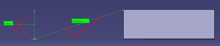

Hello all:
It seems that "GetMinimumDistance" will return the same result like measurement by "Any geometry, infinite". But what I want is measurement by "Any geometry"
I didn't find other solution in the forums. Do anybody know how to achieve this? See attachment.
My current solution to be that try to project this point to the face, if returns error then the value of "GetMinimumDistance" will be ignored....
