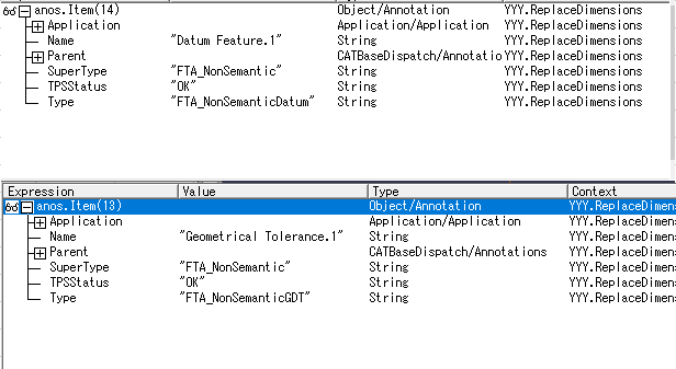

are those semantic or non-sematic annotations?
regards,
LWolf
thanks for helping me.
Both of them are non-semantic annotation.

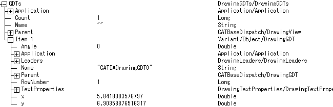

I only found the DrawingGDT that had coordinate of Geometrical Tolerance in DrawingView, but couldn't find the object for a datum.
even if DrawingGDT has the coordinate, there are not a way to get the DrawingView from an annotation object of them as far as I searched.
I go to there from an annotation of text or dimensin that are in the same View because of using Get2dAnnot.
