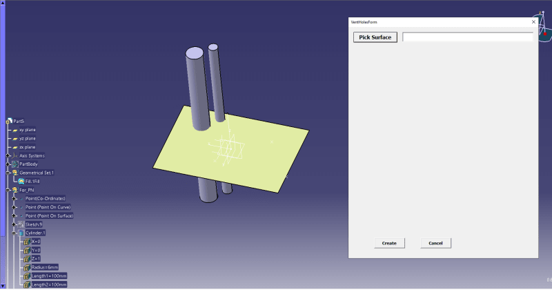

Hi
i am facing this issue where i need to get the name of the hybridshape or surface which is selected
but its not working properly here is the userform and macro
when i select it shows "CATIASelection7"
but it should show Fill.1 or whatever the hybridshape that is selected
here is the VBScript

oSel is the selection element, so it's name is something with Selection. oSel.Value is the selected item.
regards,
LWolf
it is giving error Object doesn't support this property or method
sorry, osel.item(1).value
regards,
LWolf
osel.item(1).value
Still not working

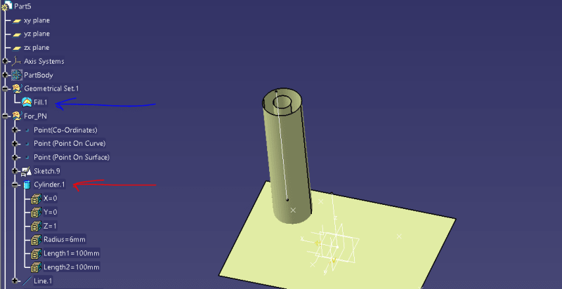

but i tried this it is getting only FILL shape name but other hybridshapes names
here is the image
if i select flat surface which is fill it is showing correct name
if i select cylinder surface then also it shows Fill.1 name
but i want it to show the surface name whichever i select
here is the macro i wrote
i think you can do it from this macro help
