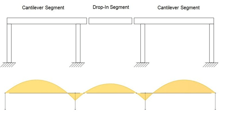

Hi all,
I've modeled and designed Gerber systems through RISA 3D, but this is the first time that I'm attempting to model it through RISA Floor, but I can't seem to figure it out, if it's even possible.
In short, I have a beam that's spanning between two cantilevered beams. I can't seem to figure out how to draw a beam between two beam ends as the program does not give me an option to snap to the beam ends, and when I try to draw a beam at the joint where the cantilevered beam ends, I get a message saying that node is unsupported.
Has anyone done anything similar? Is this possible?
Thanks!

Josh,
A "Gerber" system (I believe this may be a Canadian term) is a method used on a multiple span system where you can take advantage of the bending moment diagrams to "drop-in" a section that is typically shallower and lighter than the rest of the beam system. Essentially, the drop in beam is simply supported by the cantilevered ends of the cantilevered beams. I've attached a picture for reference.
I drew my cantilevers using the way you explained by drawing my backspan and using the cantilever tool to extend them out. My problem arises when I try to draw the drop in beam between both those cantilevered ends. The program gives me errors about unsupported nodes. I was questioning if I was simply not drawing them properly, or if the program was even capable of connecting members to cantilevered ends.

Plastic design for a UDL... the connection has to have a shear/moment connection. Lighter section and fewer parts... nearly always less costly. Limited to a class 1 section. Alternate loading only affects the splice moment... End plate connections are quite economical. If 4 span, the interior beams are even lighter.
In my case, it's a 3 span system and the client wants a shallower beam in the middle for more head room, so I believe the Gerber is the best way to achieve the shallowest section in the middle span. Let me know if I'm mistaken.
correct...
Just updating and I recently jumped back on this project - I managed to model the Gerber system discussed above on RISAFloor. I needed to use the "draw to a colinear location" feature as opposed to inputting a specific distance to allow those cantilevered ends to support a beam between.
