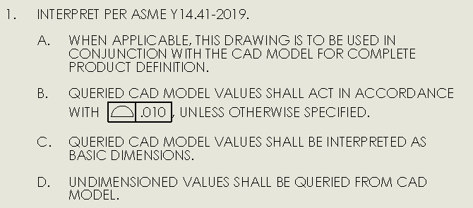

Good afternoon fellow engineers. I had a quick question regarding the contents of this drawings GENERAL NOTES. I want to know if anything that I defined in the general drawing notes directly violates anything withing ASME Y14 Standards.
[ul]
[li]Every part will be sent to a manufacturer with a STEP file and a PDF of the technical drawing.[/li]
[li]We are using an ALL OVER profile tolerance with datums.[/li]
[li]Every drawing will have datums on it.[/li]
[li]Drawing may or may not be completely fully defined by dimensions on the sheet[/li]
[li]When dimensions are not shown, any missing dimension or value should be grabbed from the CAD Model[/li]
[li]If a value is pulled from the model, then it should be considered BASIC because I want the value to have a tolerance based off of the profile[/li]
[li]We currently have an issue where a decent amount of drawings are note fully defined by drawing dimensions (which manufacturers are okay with) but we have a machinist who does everything by hand, so he requires fully dimensioned drawings. This led to the reference dimension section about how they are BASIC. I am super uneasy about this and I think it may clash with ASME.[/li]
[/ul]
Does it still make sense?

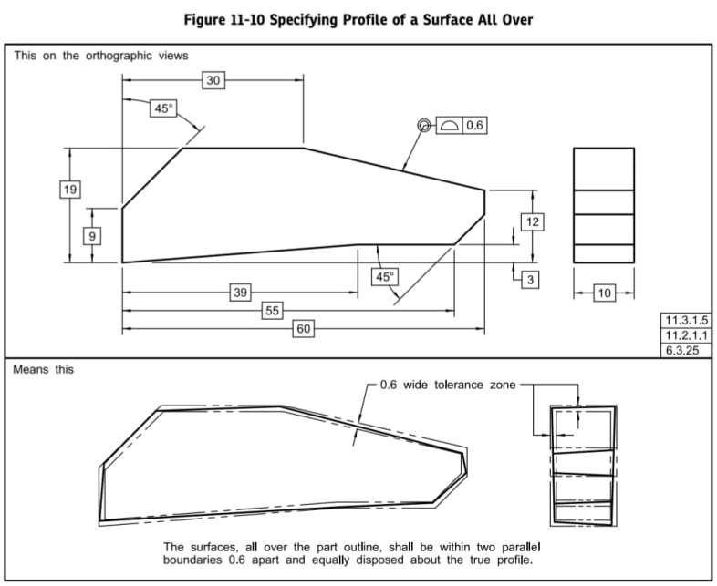

I assume you mean that you wish to specify the all-over tolerance without datums as a general tolerance in the notes, while there are datum features designated and geometrical tolerances that reference those datum features in the drawing views. Is that what you mean?
I would say that this is an unusual scheme but it is possible to do so if that truly captures your design intent.
Most of the time though, as I've mentioned before, one would want to reference the functional interface surfaces as datum features in the general tolerance requirement and NOT apply it all-over.
Anyway, here are my recommendations so far listed and hopefully clarified some more:
1. If you do not reference datums, as in your latest embedded image of the drawing notes, specify all-over to avoid disjointed tolerance zones.
2. If you prefer to specify all-over anyway and you are still not sure whether to reference datums or not, consider not specifying them as they will not provide you any added value - not even for inspection convenience. I will address this later.
3. If you prefer to reference datums anyway consider not specifying all-over and controlling the datum features separately on the drawing views.

Option a.
Consider a simple square prism with basic dimensions 5 X 5 X 5 mm.
If you tolerance it by profile all-over within 0.2 with reference to A, B, C where datum features A, B, C are 3 faces of the cube, the only way to inspect it is to simulate 3 perpendicular planes (datums) either physically by using inspection blocks or digitally by your CMM program, engage the part with the datum feature simulators (the inspection blocks) or the true geometric counterparts, establish your true profile and tolerance zone in a fixed spatial relationship with the datums, and check conformance and actual values for the profile requirement.
When the part is constrained to the simulated datums, each of the datum features will have only 0.1mm of tolerance available for variation (half the tolerance zone).
Option b.
Now consider that the profile is specified all-over without referencing datum features. This means that as far as the designer's requirement is concerned the tolerance zone for the entire part is not tied to anything. You have two possible ways to inspect this: either scan the whole part and perform a best fit procedure, or repeat the exact same process as for option 1 above. Even though per the drawing the tolerance zone is not constrained to anything other than the 5 X 5 X 5 true profile, it won't be wrong to support the part on the inspection blocks if inspecting 3 of the faces relative to the planar fixture surfaces that contact them is feasible and this method is more convenient or cost-effective. A part that passes the hard-gaging inspection process, would also be approved by the best-fit procedure.
On the other hand, if the datums are referenced in the profile all-over requirement, a part that passes the (inadequate for this case) best-fit inspection, would not necessarily pass the datum-constrained inspection. So if functionally the two options are adequate, Option a. may actually reject some good parts and cost the company some extra-money.

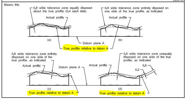

My only question is about the following sentence:
If a cube has the "bottom" surface as DATUM A, why wouldn't it have a profile tolerance band of 0.2. Is this because its outer tolerance zone (the 0.1 tol zone larger than nominal) is constrained by fixturing so the tolerance band can only go into the part?
I guess what I mean is, if I specify DATUMS in the general tolerance, the profile tolerance is based off DATUMS, effecting where the true envelope will lie on the part? Meaning the envelope with be oriented via the DATUMS VS there being an envelope based of the nominal part (when the profile doesn't have DATUMs associated with it?

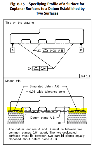

I guess what I am looking for is an image like this, comparing the use of DATUMs in the profile tolerance Feature Control Frame vs no datums in the Feature Control Frame.
Sorry if I am being difficult haha
This would be the best images I could find. Where the DATUMs are specified the ALL OVER profile tolerance cannot be outside where it is fixtured?
Yes, but that is not only a result of the physical fixturing. It is the result of how datum planes are defined to be established according to ASME Y14.5. A primary datum plane is a plane that contacts the datum feature at the three (at least) highest points of the surface. When you reference datums in the profile FCF in conjunction with all-over the true profile - which is located in the middle of the tolerance zone (for the default bilateral equally disposed profile tolerance), is coincident with the datums at the datum features. That way the true profile (and the middle of the tolerance zone is consequently coincident with the highest points of the datum feature's surface. So any variations of the datum features are only allowed into the material, relative to the true profile.
By the way, I forgot to mention that if you are going to specify a general all-over tolerance as a note while having datum features and tolerances referencing them in the views, you have to make sure that all geometrical tolerances in the views are tighter than the general tolerance. Everything in the views should be a refinement if the general tolerance is all-over.
YES THAT ALL MAKES SENSE. Wow that took awhile to finally understand haha. So with that said, it sounds like I definitely do not want to specify DATUMs in the general profile tolerance because there is a potential for parts to be flagged during inspection due to the fact that I made the General Profile Tolerance related to the DATUMs.
Regarding this. Yes we have the general profile tolerance at .010 and all of our other dimensions are +-.005 or tighter.
So... It would be in my best interest to:
[ul]
[li]have DATUMs in the drawing view.[/li]
[li]no DATUMs in the GENERAL PROFILE TOLERANCE located in the GENERAL DRAWING NOTES[/li]
[li]have an ALL OVER callout before the GENERAL PROFILE TOLERANCE to avoid disjointed tolerance zones[/li]
[/ul]
