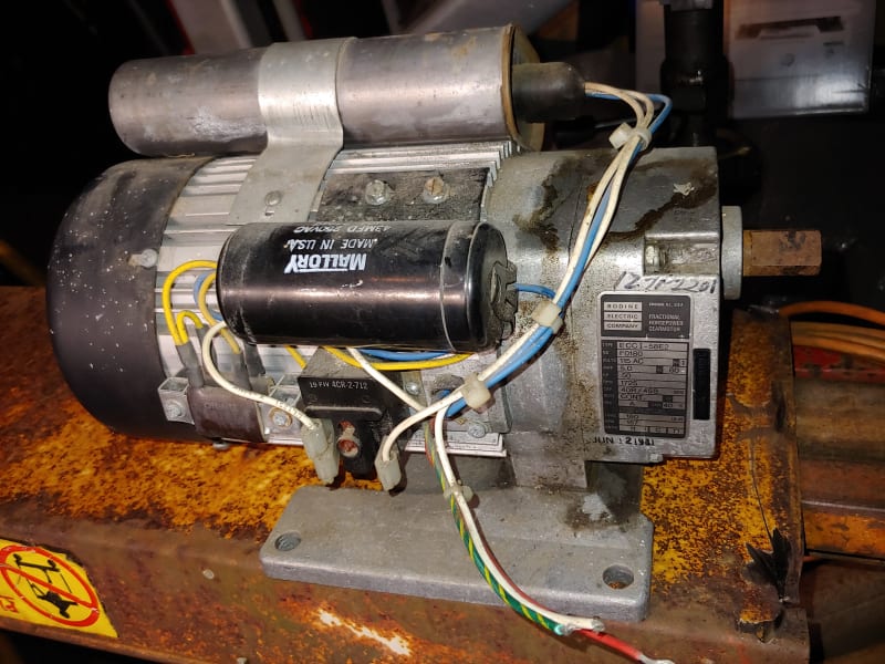

This is probably a simple question to answer if this is your specialty but not my area of expertise. Got a 1/2hp early 80's Bodine 1 phase fractional hp parallel gearmotor and want to know if it can be wired to accept a reverse switch for the occasional use in reverse. The gear turns at 157rpm CW (11:1 ratio 1725 rpm motor). I do have a spec sheet that states under rotation CW. However in the bottom left it does sat under remarks: Wind per Dwg #12655
Connect for "CC" rotation
Could this mean that it can be wired for reverse as well?

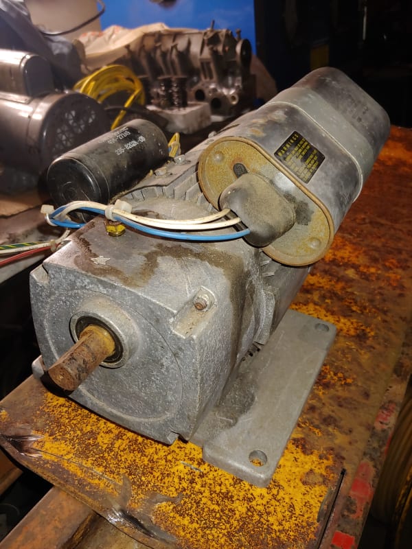

Here are pictures of the motor and tag

For your spec sheet its note of CW rotation is presumably the output shaft. The "connect for CC rotation" note may be for the motor itself with the difference being because of the number of rotation changes in the gear box.
For your wiring question:
-the nameplate gives the capacitor sizes as 40 mfd run / 45 mfd start so that will distinguish the 2 cans on the housing (okay, the black one says 43mfd)
-the brown lozenges at the lower left with yellow wires look like resistors, unusual and so would make me more hesitant about guessing the reversing connections
-the black cube with the red button is probably the centrifugal switch (well, funny location). 3 connections instead of 2 make it look suspicious too
-by the labelling there is a thermal protector, another connection point to account for. I don't see it on the outside so we might have to look inside to complete our understanding of the wiring
-the only clear wiring is the cut supply wires of red=hot, white=return and green/yellow=ground
As a design family this motor is very likely reversible but I see enough complication that I would be hesitant without the maker's info. I can trace many of the wires in your photo but not enough. This PDF suggests that swapping the main winding leads would reverse it but I can't see enough of your wiring to tell, especially inside the case. Even then if this has been custom built for one direction it may not have equal performance in reverse even if it can be reversed.
