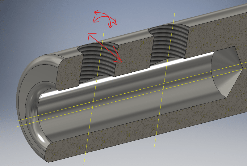

Hi all,
My coworkers and I can not agree on the proper GD&T for this situation:
We have a shaft, with an offset blind hole in it. There are 2 threaded holes which run perpendicular to the hole. I need the GD&T to indicate that the set screw holes need to go through the thickest section of the part, otherwise the screws used here will fail in various ways.
Due to the constraints of the design, we cannot change the thread pitch of the screw holes.

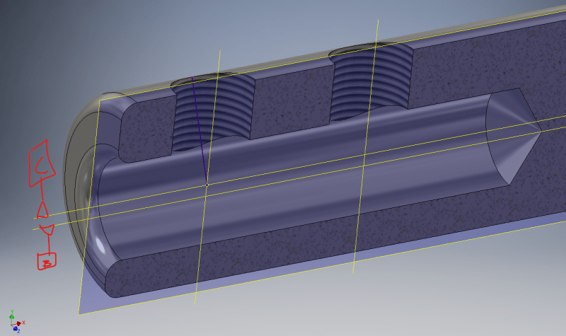

This is what I have proposed, but I also feel at the same time that it's overkill. I'm also unsure if my perpendicularity callout on the threaded holes makes sense, since it references a derived median line datum, and a feature of size datum that is parallel to first.
And one colleague takes issue with the datum scheme, saying that the shaft should be the primary or secondary datum.
I'm curious to hear what solutions come to mind.
Sorry the question was for Eric, I was trying to understand why he thought it would be better to spec the GD&T at RFS.
If the thread position is called out at MMC you'd have to use an MMC thread gauge to check the holes and the gauges would wiggle in the hole, making it impossible to know what you're really getting. Also, considering that the threads are helical wedges that complicates the checking method because you have to engage the threads at the pitch diameter. Having the note MINOR DIA under the feature control frame would've helped a little but I think the easiest is to use RFS. The RFS gauge would ensure you've accurately captured the axis of the thread. When using RFS you can just open up the positional tolerance some since you're not getting any bonus tolerance as with MMC.
