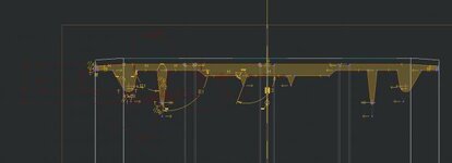

I did a gasket using revolve option. I did a sketch of it and later turned around an axis.
Now on a drawing I would like to make a cross section view like attached. I tried playing with views but I could just cut the whole gasket in half and see the insides.
I would like to have a view only of a sketch like attached.
Is it possible?

imo - you should obtain such result by default!
If I were you I would create X-sec in model in the same plane as skecth of Revolve feature was made, then turn on this section in Properties window in drawing mode.
thank you Jacek. I had to do an assembly and then a x-plane view. Before, i tried to do it in part.
