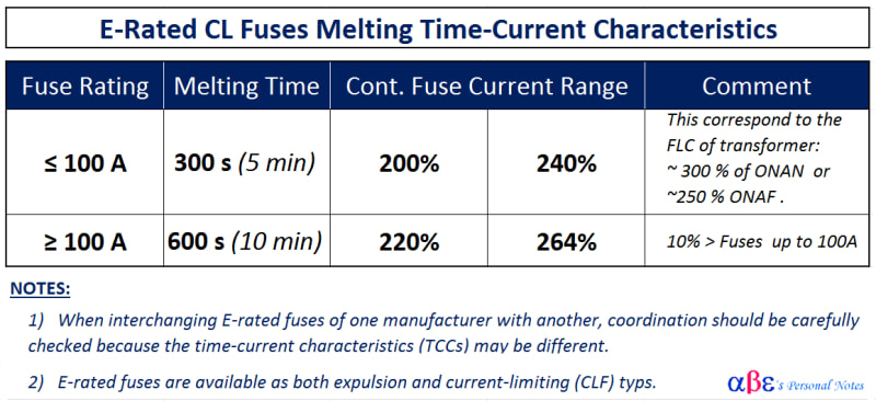

Hi Mbrooke,
It recognizes implicitly that any fuse does not provide protection in the overload range. However, the IEEE standard sets a benchmark for the E-rated fuse melting time-current characteristics in the range of small overloads of the transformer. E-rated fuses are not intended to provide overload protection. They should only be applied in situations where it will not be required to open small overcurrents.
Below is a summary table with the characteristics of the E-rated fuses that I hope helps to provide some light to your post.
It does. But why mandate 200 and 220%? Why not leave the discretion to the manufacturers?
So that E-rated fuses are somewhat similar. The higher current/faster tripping portion of the curves vary, but for continuous ratings it’s not necessary to know which 200E, just that it’s a 200E.
Probably the reason for that is for making the selection of MV application easy and allow code and standard to develop practical application rules.
It goes back to the applications for which the fuses are intended to allow for:
1) The fuse’s continuous current rating must be able to withstand transformer overloading and emergency operation and meet the NEC requirements.
2) To provide moderate overload protection and allow start under cold load pickup conditions without tripping the fuse.
Ok- but I thought the NFPA/UL had no influence over the IEEE?
Although those organizations are independents, they providing application guides in the same marketplace for the same subject matter. The physics of the phenomenon drive the results that should be with reasonable similarity.

I just realized HPA type PF, PX and PM fuses start at around 110%, while PE fuses aligned with the IEEE start at 220%. My question being, why does Southern States start their fuses at 110% and not follow the IEEE?
The SS fuses PF, PX and PM are type N fuses (no E-fuses). Therefore, they meet the continuous current range per IEEE Std. See the excerpt below from the fuse manufacturer.
